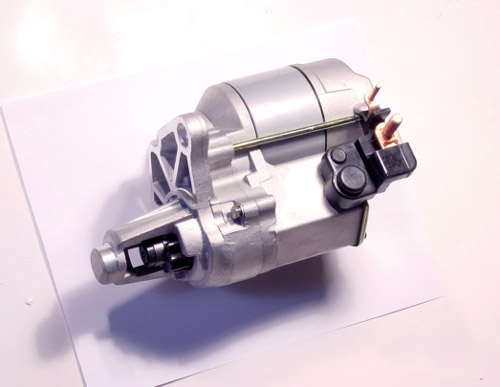

Many Mini Starters, like the one pictured here for example, come stock with a secondary set of removable terminals preinstalled that must be removed before fitting the starter up to a big block. In this case, the entire black plastic assembly (complete with it's own set of terminals) is removed to access the main terminals, which are located underneath the two button bumps on the black plastic cover piece. Once this plastic assembly has been removed it will look exactly like the hookup on the PowerMaster unit pictured above.

Thanks! Great stuff! I have the same mini starter as in your picture. I have it on my 70 Road Runner with a 383 and TTI headers. It fits fine, although installation is a PITA. However, I never thought there were secondary terminals. You just taught me something new. I will remove the secondary terminals and give myself some extra room...

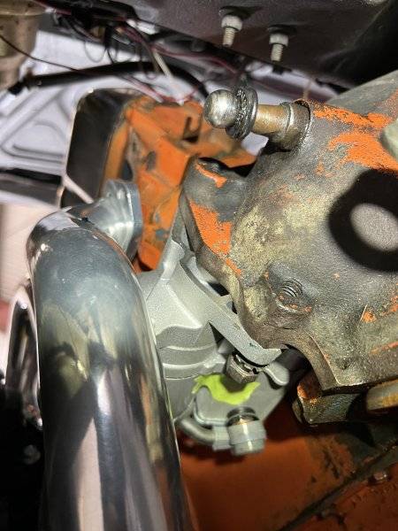

Not to take over this thread but am curious as the Mopar licensed proform (mini denso) I just installed on my 440 4 speed doesn’t match the bell housing. Wondering if this is due to the starter application being for A, B, & RB engines or because it’s a manual transmission? I haven’t seen this figment issue elsewhere and the part indicates it’s for my specific application.
Also seen just shields from 440 source specified ONLY for auto transmissions.

Was this a 4 speed car? My housing doesn’t seem to match very well and depending on what Proform says I may look for an alternative that truly fits.
