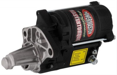

The terminal block is on the other side from the OEM one..at least it was on the one I had. Had to put my old one back on..Then I went and ordered this:
Fit's like a glove and does a great job..
Many Mini Starters, like the one pictured here for example, come stock with a secondary set of removable terminals preinstalled that must be removed before fitting the starter up to a big block. In this case, the entire black plastic assembly (complete with it's own set of terminals) is removed to access the main terminals, which are located underneath the two button bumps on the black plastic cover piece. Once this plastic assembly has been removed it will look exactly like the hookup on the PowerMaster unit pictured above.
Thanks! Great stuff! I have the same mini starter as in your picture. I have it on my 70 Road Runner with a 383 and TTI headers. It fits fine, although installation is a PITA. However, I never thought there were secondary terminals. You just taught me something new. I will remove the secondary terminals and give myself some extra room...
Yes, but I didn't like how close the terminals on the actual starter were to the block so I molded my own using 3M DP420 epoxy. For the terminals I silver brazed some CU battery cable to ring lugs and made a Delrin block to hold them in place for the epoxy. Came out pretty good and seems strong.
