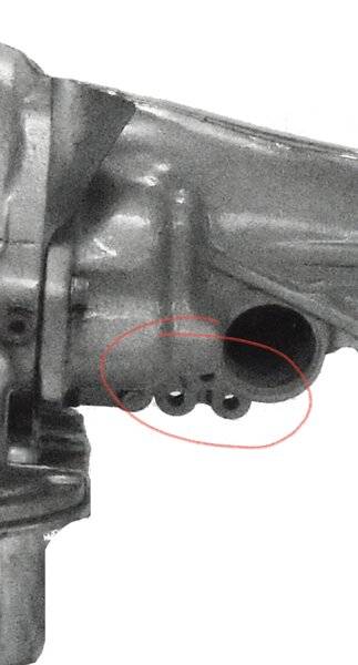

If the '73 is console shift, the '67 trans might not have the "bumps" under the tail housing to mount the shifter bracket.
Oh no not another setback lol. What do these bumps look like? Anyone have any pics of said bumps? My car is definitely a console shift with the slap shift.
Are these the bumps you're referring to? I drew a circle around them on a picture I found online. If so I'll look when I get home after work.
