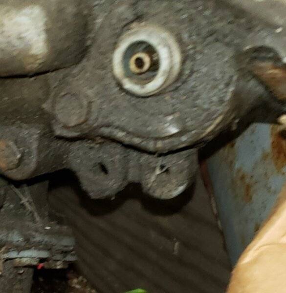

Using a 67 727 in a 73 Any negatives?
Looks like its got the "bumps" though very dirty lol.
The '67 727 tail shaft housing has the console shift bracket holes. Here's a tip for installing the torque converter: reach in past the torque converter seal with a thin screw driver or pick and turn the oil pump drive lugs to 6 o'clock and 12 o'clock position. This centres the oil pump rotors in the pump cavity and makes it easier to engage the converter elements.
False alarm, it appears that trucks are the only ones that don't have the bumps.
