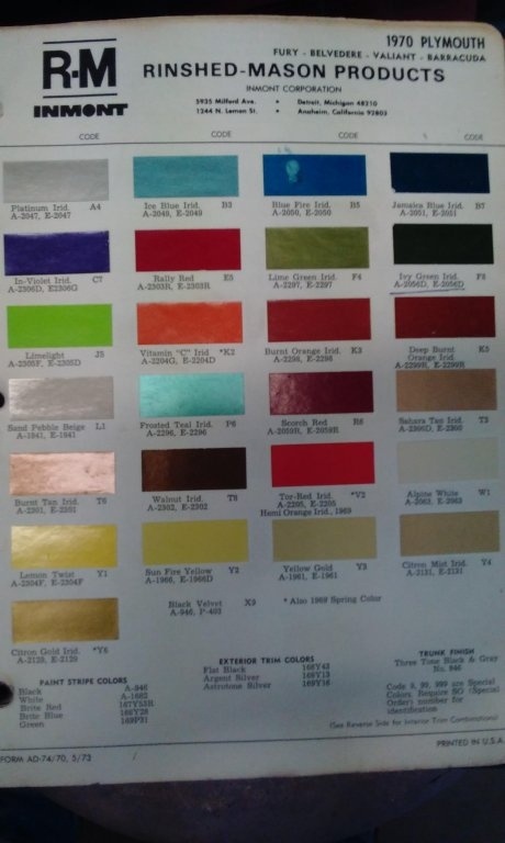

Was V2 ever available on a 69 Plymouth ?
I have seen some conflicting information (I know, big surprise !)
The ppg 1969 Plymouth chart shows no V2 available (but it is in 70), but the 1970 r-m Plymouth chart shows V2 with a note "also available in spring 1969"
I'm under the impression that V2 was available only on Dodge beginning spring 69, and K2 was available only on Plymouth beginning in spring 69 , then in 70 Plymouth picked up V2 and Dodge picked up K2
Am I close ?
Or are there actually 69 Plymouths out there that came from the factory painted V2 ?
thanks !
Was V2 ever available on a 69 Plymouth ? No
I'm under the impression that V2 was available only on Dodge beginning spring 69, and K2 was available only on Plymouth beginning in spring 69 , then in 70 Plymouth picked up V2 and Dodge picked up K2 Correct
Am I close ? Nope. Your accurate.
Or are there actually 69 Plymouths out there that came from the factory painted V2 ? Doubtful. If there were, they would be coded 99 for the color and not V2
Ok, thank you very much
I was getting confused by a RM 1970 Plymouth color chart that indicates V2 (tor-red) as being available in spring 69 , but it also includes Dodges color name (hemi orange), so I think it is not necessarily accurate as far as being "brand specific" to Plymouth
The ppg charts seem to be more informative (and accurate)
