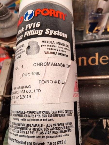

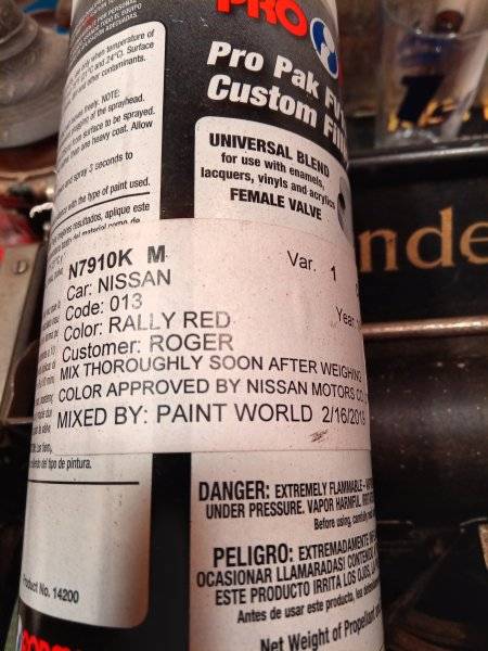

In my case as my car had a respray it came up as some red from 1985 which l can't remember but let's say it was Toyota red. Either way the color matched what was on my car.
The paint shop that I'm going to has one of those cameras. But when they match the color, does it give them a formula to create that color OR does it just give them the color code that most resembles it? For instance, will it say V2 is the color or will it say V2 plus .02 percent more white (or something like that) is the color? That's what I'm wondering
Just took a look in the basement and lucked out l still have a can of it. 1980 Nissan Rally Red.

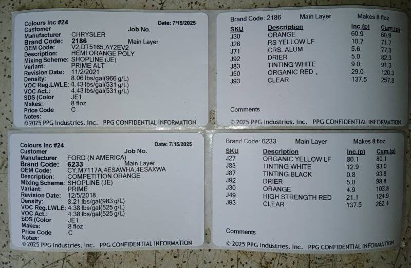

Well, my worst fears were realized. I went to the local paint shop and had my paint scanned and they said Ford Competition Orange (CY) is an exact match. They also printed out the V2 formula and we compared them and it's nowhere near the same as Ford Comp Orange. I don't know what to do. I might go somewhere else and have them scan it and see what the second one says.
V2 is technically the code, the E or other letter is the designation for the first year it was used. Hemi Orange is the same as Tor-Red, Vitamin C is the same as Go-Mango.
