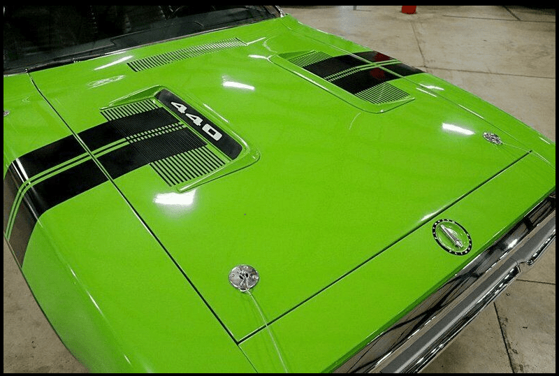

I have been looking at the fender tag of my car 1971 GTX , and seeing what i need to buy to restore its former glory. i stumbled across this.... now iam puzzled. My car has a V21 code and a V7W performance hood treatment and accent stripes "white".
i assumed it would have the 440 callouts and the fender stripe but then i saw a couple cars seen below . seems odd to double decal in the area , one of them was sold at VOLO auto museum previously.
is this what it looked like? if any of you have this coding could you provide pictures?
Thanks
V7W is logitudinal stripe white - painted So that’s the thin pinstripe that runs the length of the car over the wheel wells.
V8- is the sport stripe transverse. So it goes from the hood scoops over the fender to the wheelwell.
V21 Hood performance treatment, it is the dashed lines in the scoop area.
Yup
Yup
