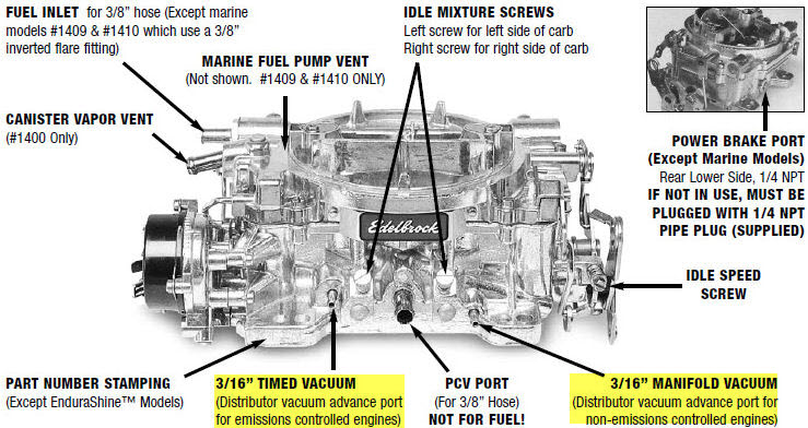

Seems like there's some agreement from Edelbrock on that. Using the manifold vacuum helps low speed/ light throttle running but also increases NOx emissions.
