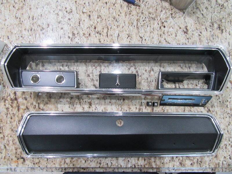

Just received these back and the quality of the work looks great. They did the bezel and glove box lid, heater control panel, polished the lenses and did the two little control knobs.

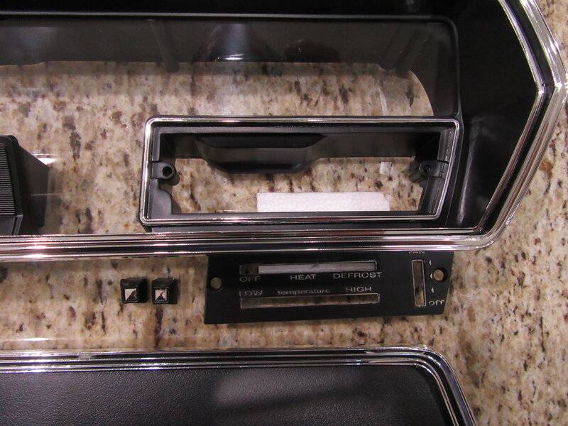

Only issue is the outer edge that returns to the dash frame was left exposed chrome and not blacked out on either piece - at least the outer edge on the restored cluster face on my 67 GTX is blacked out and I think it should be on the 66 also. Can someone confirm this is correct for 66 also?
If it needs blacking out I'll mask and paint it myself with SEM Trim black rather than risk sending it through the shipping services twice again.

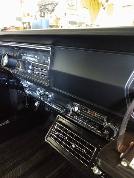

Outer edge on mine is black.

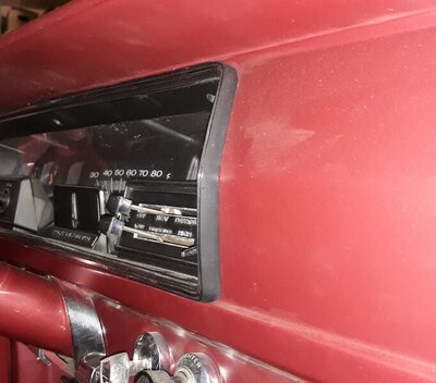

Outside is Black...per my Mr Gs restore 10 yrs ago.

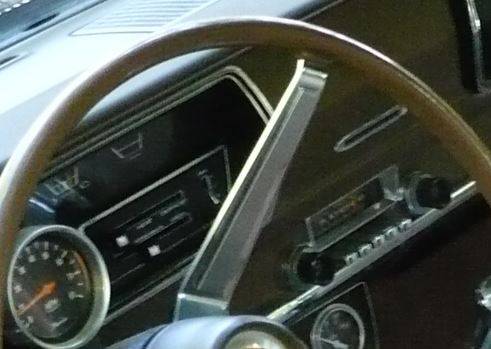

Now with Dako's picture, that edge to dash is black. Thought you meant the outer of the 2 bands facing driver.

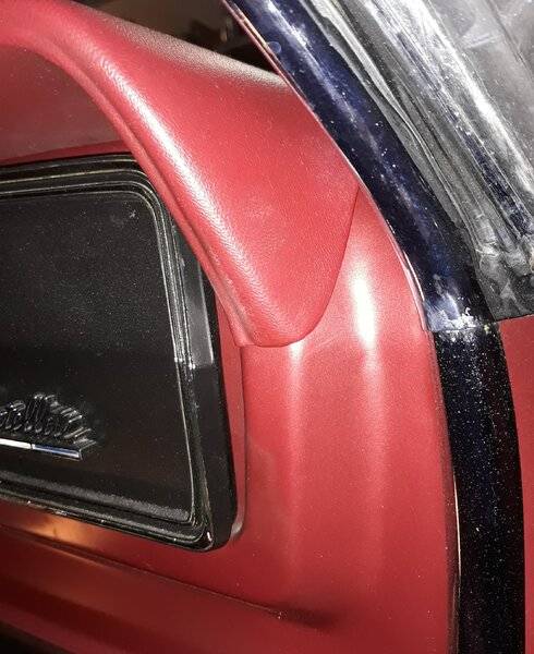

I have two glovebox doors off my 66 Belvedere and the outside edge is black.
