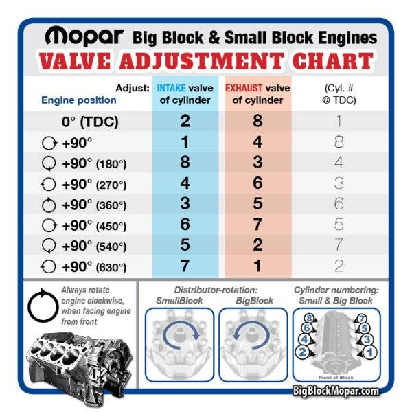

This chart will help you adjust the valves.

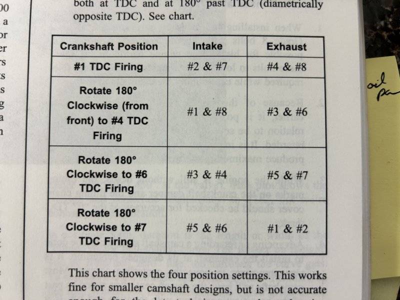

1) Find TDC on the firing stroke of #1 cyclinder - use that as your starting point to adjust the valves per the table attached below
2) back off the adjuster screw on the valve you're adjusting to the point the pushrod has play.
3) slowly tighten the adjusting screw while spinnig the pushrod with thumb and forefinger of your other hand. When the pushrod binds you are at ZERO preload and zero lash.
4) Tighten the adjusting screw and additional 1/2 turn to yield the preload and tighten the nut.
Done. Now do the same for the remaining 15 valves.
