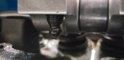

IIRC, the recommendations from the rocker manufacturer was to shoot for 2 threads showing beneath... I can dig up the information but I think that was recommended. May I ask why you'd shoot for 0 threads showing? Just not a recommendation I have heard prior.
What brand of rocker?
Generally, for most rockers, the magical one or two threads showing is recommended by "people". As someone mentioned, how the ball/cup is oiled matters as well. Generally, you want as little adjuster hanging out below the rocker body while maintaining good oiling. The angular load on the adjuster becomes very large a full lift. The more it is haning out the bottom of the lifter, the worse it gets.
The one to two thread general rule seems to be recommended without consideration of the type/style of adjuster. See the link.
https://blog.trendperform.com/introducing-trend-performances-new-rocker-arm-adjusters
Some have the ball more extended from the last thread. The one to two thread recommendation, which has been around for about 50 years, was usually for the short adjusters found on the rockers available at the time.
So in your case, it looks like you have nearly 4 threads showing and a long adjuster. I'm guessing that your pushrod cup is nearly 1/4" away from the rocker body. I would shoot for 0.060 -0.090" Your oiling is directed right at the top of the underside of the rocker.

I think you can simply look at the rocker and see how the pushrod cup is oiled. It's pretty clear in one of the pictures.

Switched to Hughes rockers and set up the adjusters to have clearance on the rocker at full lift and have the squirter hit the ball/cup. Here is a picture of my current setup. Zero issues.
I agree the adjuster looks to be out to far.... But at the same time if the pushrod is to long the cup hits the bottom of the rocker instead of only riding on the ball, and that situation results in similar damage.... People tend to think rockers are the simple part of building an engine... It's not, there's allot to pay attention to, if you don't it will bite you..

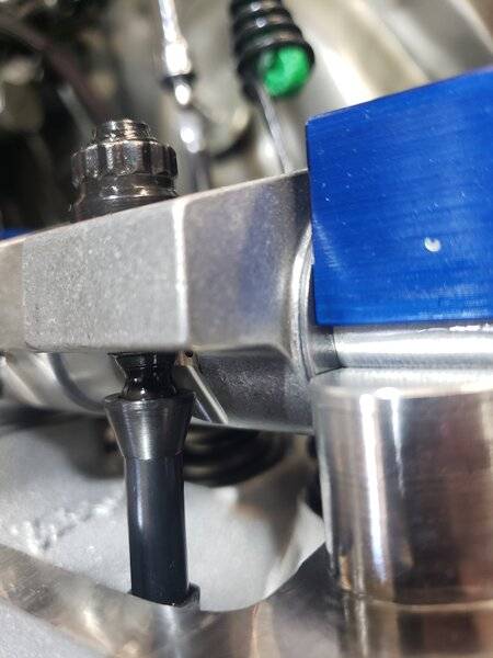

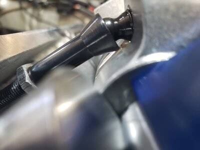

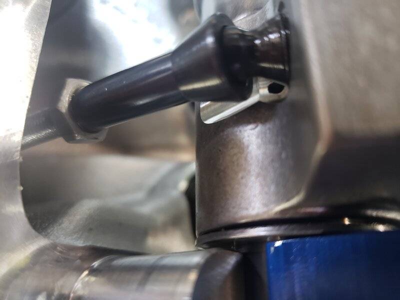

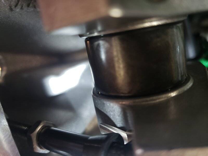

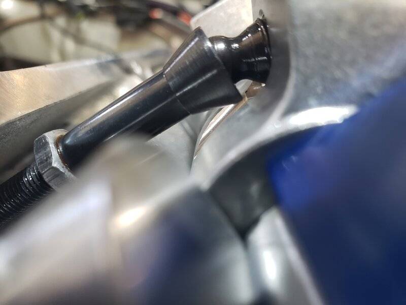

I have verified Cam/crank timing and am getting to the point of measuring for pushrods. I am not making my own and will be ordering a set (Smith Bros, Trend, Manton are the current contenders unless i happen to fall on an off-the-shelf length. I have everything mocked up currently and wanted to see what everyone thought of my rocker adjusters.
Thats a long adjuster being used with a press fit push rod.
Imagen the side load when that swings upwards.
You might want to extend that adjuster 3-4 / 1 turn as this is close..
Check again with 1 full thread below the rocker arm.
I can highly recommend Smith Bro's their product, i got a set from them also.
I bet that aide load is why I broke one in the first place. I'm trying to get it right this time around.
I appreciate the feedback and was wondering if it needed to be a bit longer but I'm conflicted and stuck between the different recommendations of having it as short as possible, best oiling position, and the general 1-2 threads rule... I'll try to get a better picture showing the oiling hole as that may make a difference based on the research I have done.
