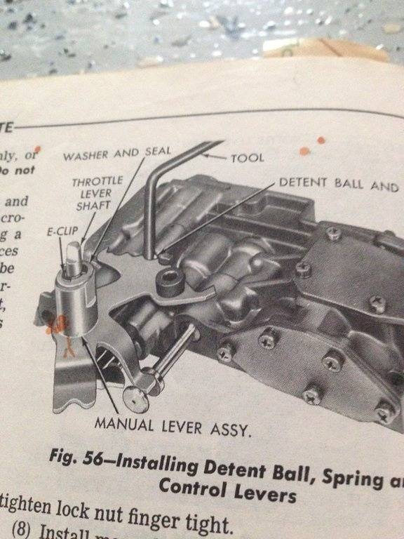

Controlling the elusive spring loaded dent ball will be the most challenging part. I need to build a tool to contain the little raskil.
Do the change over inside a cardboard box that way if the ball pops the little rascal won't fly into your work area and get lost forever. I had to remove and shorten the spring for the ball to soften the shift detents and did it under a cover of plastic food wrap.
Anyone ever seen a tool to do this with? Surprised there is not a grenade pin to retain that little ball.
I have had one excape a cardboard box. Projectory must be maintained.
5/16" rod with a hollowed out section to hold the ball? Steady hand & small screwdriver works just as good.
Never used one I think it's all arm strength, it's not all that stiff.

If you buy a TransGo TF-1 (or 2) kit for the valve body it contains a mumbly peg thing-a-ma-jig for installing the detent ball. Works really well. Also the shop manual shows a bent metal retainer that can be fabricated to hold the ball while dropping the shaft in place.
