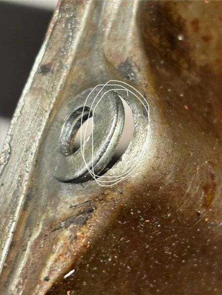

Hi All. Chasing down the dreaded / usual valve cover oil leak in 73 Roadrunner 400 / 6.6L. Come to find that the valve cover has been cracked due to too many “uga ugas” in the past. I’d curse out my brother in law / prior owner but he’s passed on. It isn’t as much fun without getting a reaction tbh.
At some point the bolts were placed with stainless 1/4 x 20 x 3/4 hex bolts and washers. Got new basic aftermarket Edelbrock Chrome covers on the way for time being.
To avoid other issues. Are the bolts supposed to be 3/4 long? Washers or spreaders? Cork or newer style gaskets?

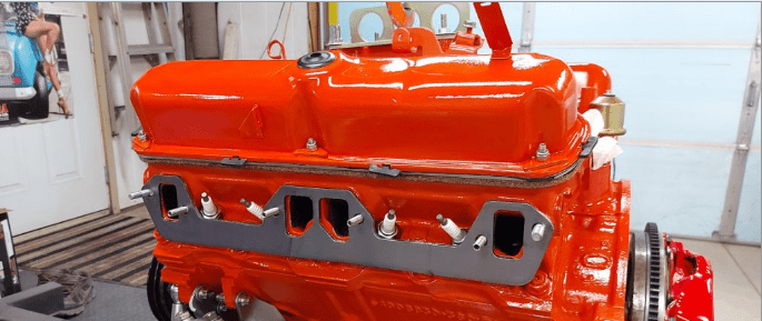

If you want OEM look.... I was getting those from Mancini..they still had original Mopar sets. I havent looked for them in a while tho. They are pretty short with captured flat washers... same ones go on the oil pan for BB.

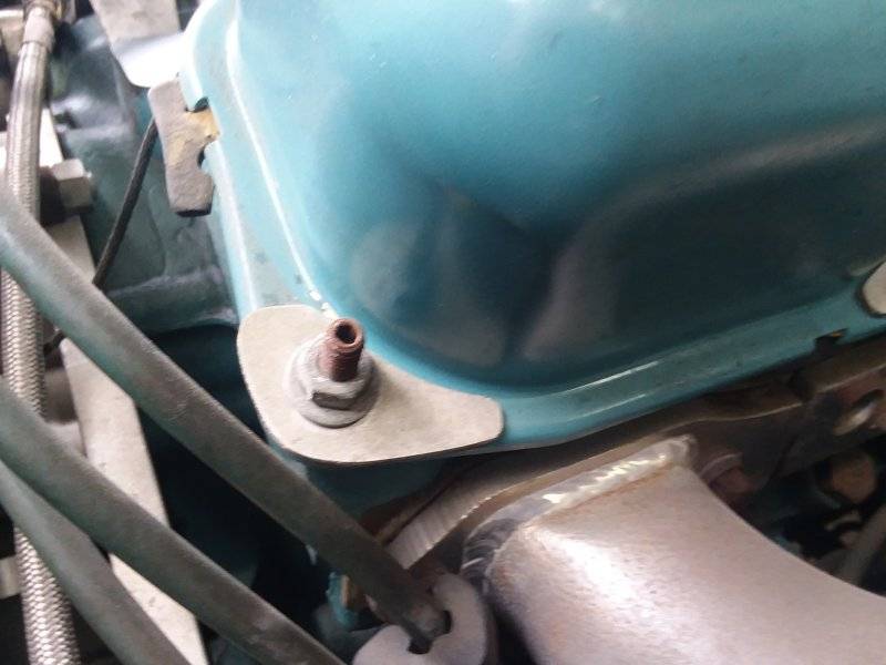

Mega Parts has stock valve cover hardware kits. Big blocks used studs on each end of the bottom row and bolts with captive washers in the remaining locations.
That explains part of the issue. There are no studs on the bottom ends. And definitely no captive washers. Its a mess.
You can get a double end stud at most any good hardware store . Pick your length based on valve cover and type of gasket choice
OEM was 1/4-20 on the end where it threads into the head.
1/4-28 on the exposed end

Hardware store 1/4-20 set screws (in the proper length, for covers chosen), bottomed into head, nuts, washers, and home made spreaders.
Paper thin moroso covers, with a coat of turquoise, rubber gaskets, glued to the cover. No leaks.
These are grade eight steel. Doing it over, I might buy stainless, but these were on the shelf waiting for me.
