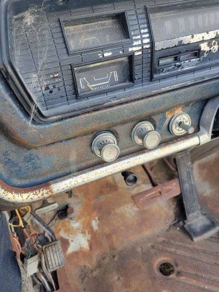

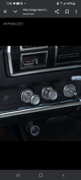

That's a super nice car. Just wondering what's up with the dash knob holes.. different from one of my 66 50 verts.. and one missing??

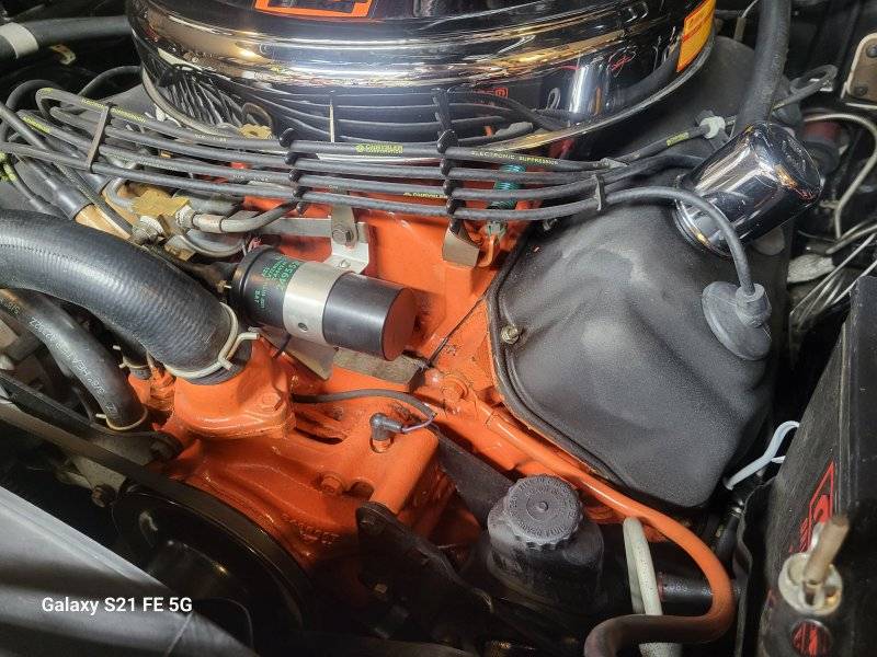

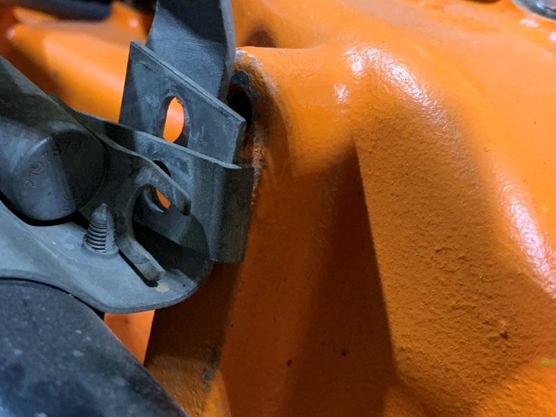

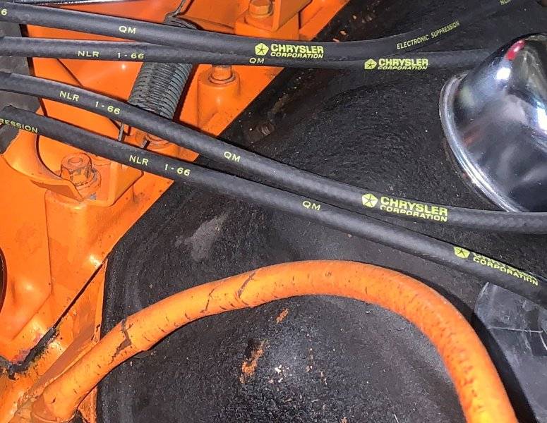

I don't show any remnants of marking. But I have paint marks on drivers valve covers like Tony's.
My drivers side valve cover has paint smudge. and my negative battery end has orange paint on it.

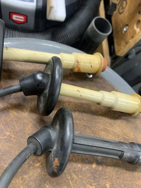

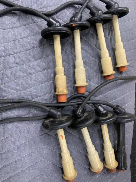

My spark plug wire valve cover boots have wet paint marks as do the spark plug boot extensions.
the wires and actual plug boots have been replaced

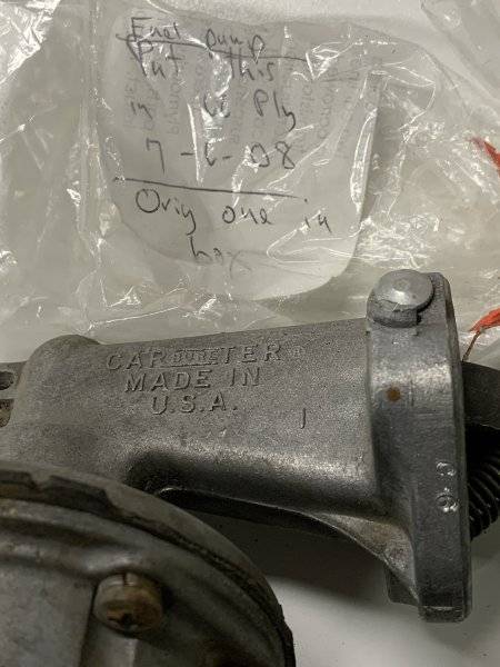

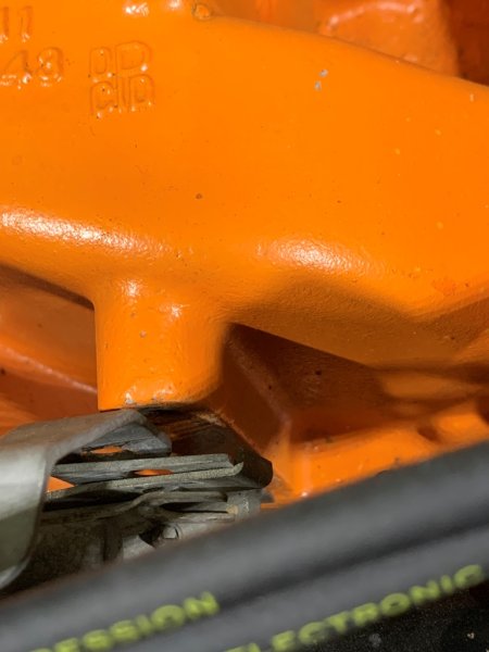

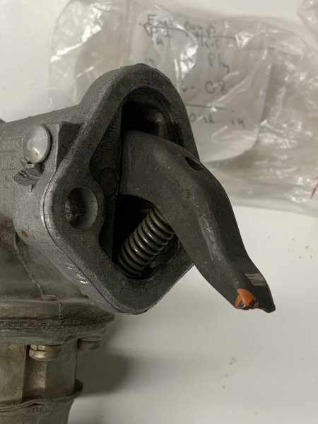

My original fuel pump lever arm has orange paint from when the factory installed it on the wet engine.

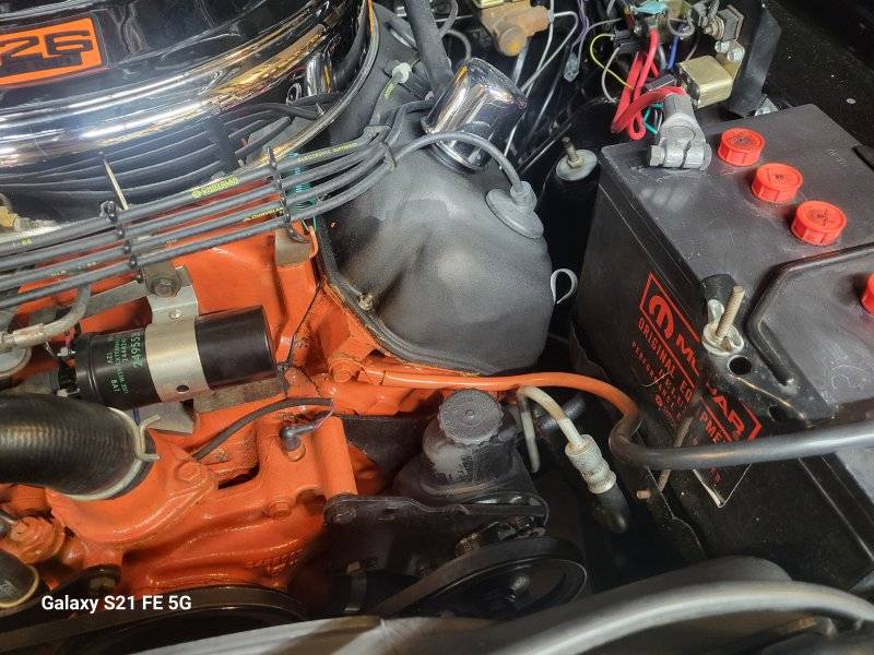

Im not 100% convinced there should or shouldn't be said markings
Ive already done the painted Neg cable thing
I dont see me recreating the orange paint smudge on the valve cover and be able to pull that off where it looks right, so odds are I'll forego that.
I have what I believe to be the original fuel pump.
I'll have to find it and look it over for comparisons sake.
ps, Yes I know the spark plug wire bracket should be engine color.
But I was out of paint, so I just cleared it an moved on ( last years project )
pss, Pwr str was added during restoration and is a Saginaw system I have some ( little ) interest in correcting / changing to TRW / Federal system

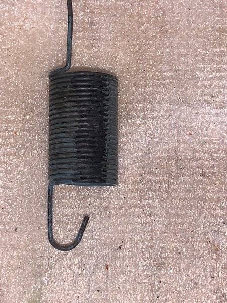

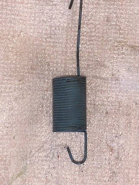

When I had carbs off again to do the intake gasket, I noticed the black painted stripe on the green front carb spring. Take a look at that.
Thanks, Hadnt noticed that
Thats an easy one to add
I have a sticking rear carb , that doesnt like to return to full idle I need to address this weekend maybe
So will ck springs at that time

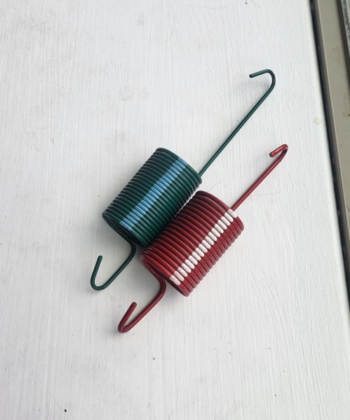

Couldn't resist
Pulled the air cleaner
I have the repop springs.
Different color stripes
Red is rear
Green is front

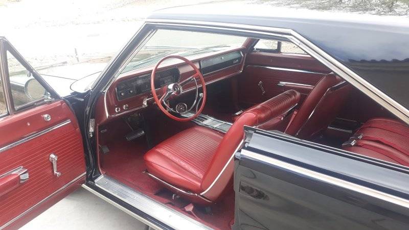

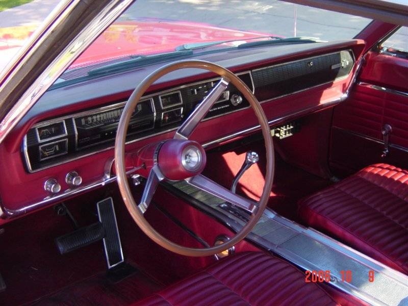

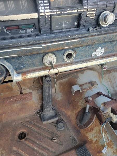

Are you talk about knobs on drivers side? 66 cars built before January 1 1966 had no flasher hole, if that's what your asking.
Thanks Fran, this is what I'm talking about; it has headlight, wiper, and flasher. What's the empty hole to the left. My top switch is on the left side, the hemi coronet is on passenger side too.

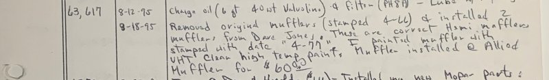

Sort of off topic, but would like to note here to share info... original mufflers stamped 4-66. SPD 4/27/66. Shipped date 6/2/66

Repop springs are all the same Hoffmans Winners Circle makes them , and only make the one set that Im aware of

Mine has the extra hole where a brake warning light would go
But I know for a fact the dash frame in my car is 1967
