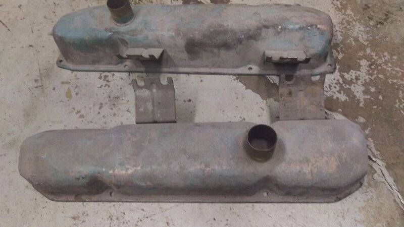

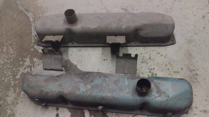

Can anyone tell me what year these valve covers are.
Thanks
They look just like my '67 383 covers. I'm sure there's other yrs too
64/65/66.
because of both have pipes for breather and PCV or draft tube. Valve cover under the pipes is flat.
they are 6 bolts So they are late 63 or newer.
They are NOT 1967, they started the rubber grommet for the PCV and a heater hose bracket welded on right side. So only one pipe on left side that came out of a raised circle stamped in the cover.
I have an original 66 model 383 never been apart and that is the same v/c as mine!
