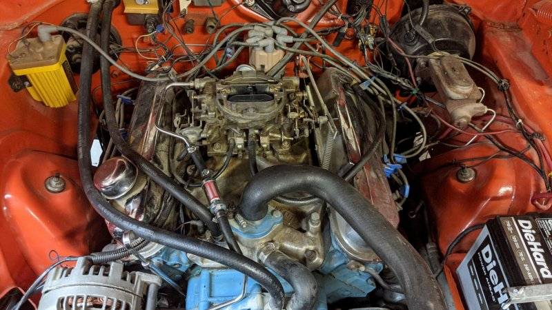

My main question tho, the Proforms, unless i'm wrong, have the pcv hole on the driver side back, and the breather on the passenger front, which matches what I have currently.. see pic attached.
The Ansen's looks like its opposite. I guess this isn't a big deal but my main issue with the current covers is the pain of pouring in oil since both holes have baffles under them it takes forever!
I think the ideal setup with be the Ansen's with an extra hole drilled for a fill cap. The pictures show places there for them. Not sure if they can do that on request or if that'd be up to me.
Any thoughts/suggestions/advice?

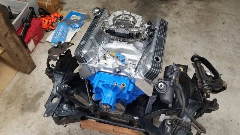

I had a set of valve covers for my 340 Road Runner that always seemed to leak. By the third time I (tried) to use them, I gave up assuming it was my issue with installation and realized it was the valve covers.
Below is a picture of my stroker motor being built with the third (and last) time I tried to use those valve covers. They looked nice until they leaked oil all over the place...
Bottom line is I learned fit is really important. I never had issues with my original stamped steel valve covers and set of old M/T valve covers seemed to work well too.

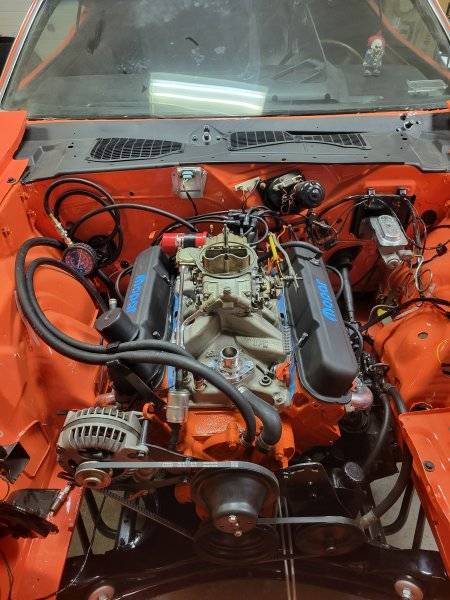

I put these on a build for a guy, but not a fan of them. Might be a hair better on a blue motor.
