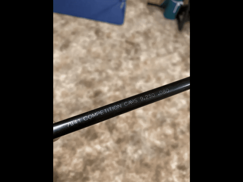

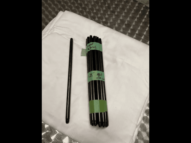

I have a nice set of comp cams 7941 pushrods (9.25") that I’d sell if you’re interested.
they are also available for summit for $122 if new is what you want.
