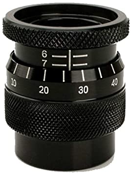

Cant do anything unless you have one of these.
Hi M67,.....I'm good with req'd meas tools,...with the spring Locator eating up 0.060" of req'd 1.86" installed ht,...what is everyone using--doing to get there ? ....tom
Im not a pro. You can't do anything until you have the valves installed. Once they are seated ( and lapped in) you will need to place the retainer and locks on the valve. Use the mic to measure what the total distance is.Subtract installed height from the actual measurement. You may need to add shims to get the correct height.
