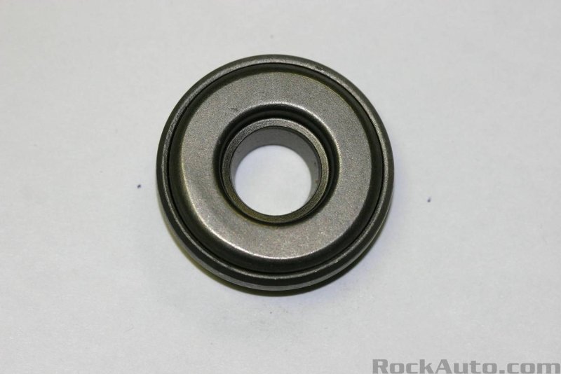

8 long and 8 short tells me there are rotaters on the exhaust valve. Very common. Do not mix them up. The intakes will take the longer springs and they will have a thin retainer. The exhaust will take the shorter springs and the retainers are thicker which allow the valve to rotate. Here is a Rock auto showing the difference. Exhaust on the left and intake on the right.

Do not use those springs with the exhaust rotator. You will pop a face off the stem. You also should be seeing a difference on the keeper grooves.

The thicker retainers are rotators. So yes you will need new retainers to use those new springs. I would get all 16 new retainers and locks.

No. Retainers go on top of the spring and the locks/keepers are what holds the valve to the retainer. You want to be sure the retainers are mated to the locks/keepers as there are different degrees of fitment and they have to be correct. Example a 7 degree lock/keeper needs a 7 degree retainer.
What you call "end caps" are the valve spring retainers. The 2 small items are locks or keepers. The thicker "rotater style" retainers you have will not work with your new springs. Retainers, locks, valves, and springs have to fit each other. No mix and match. If this is a stock cam you could purchase 8 stock retainers. If it's a better than stock cam? There are performance retainers and locks. The locks have to fit the angle of the retainer. They also have to have the correct number of grooves to fit the valve stem. Beware that some applications have different lock grooves on the exhaust vs intake valves. The retainer has to fit snugly inside the spring. Once you have all the correct parts? Spring installed height needs to be measured. Each valve, retainer, and locks should be assembled with a light hand compressable checking spring. Then with a caliper measure the distance between the cylinder head spring mounting surface and the underside of the retainer. The springs will have a desired height. Shims are available in .015", .030", .060". They can be stacked if needed.Use shims to get as close as possible to the desired height. Then lube the stem, install the valve seal, correct shim if needed, spring, retainer, and locks.
