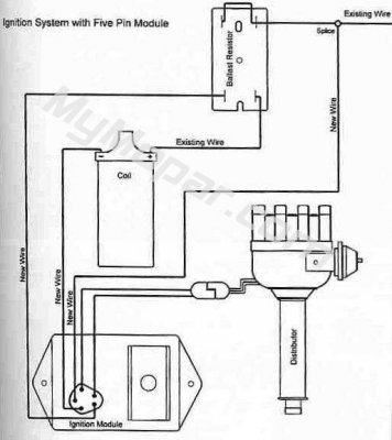

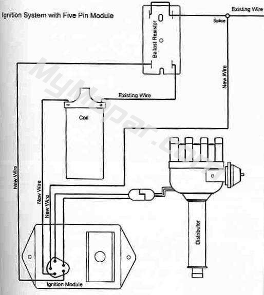

  • Chrysler Electronic Ignition Wire Diagram 4 pin Ballast & Electronic Volt. Regulator.jpg
  • Chrysler Electronic Ignition Wire Diagram 4 Pin Ballast w-5-pin module.jpg
