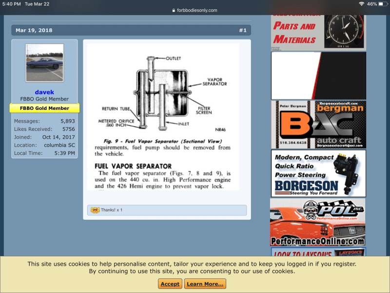

Running a carb and today’s junk gas will require a return line back to the tank with the Wix vapor separating fuel filter. You can buy it or make it but it is a .008” orifice size I believe on the vapor return side. Search my name on the subject as I had pictures and descriptions on a previous post. Get the fuel line away from the block and distributor routing. Frame rail to pump, pump back to frame rail and vapor filter, return down rail to tank, fuel up fender and up and over to carb with heat shield. That is about the best heat defense you can play.
Pictures. Memory is for sh*t. .060” orifice.
