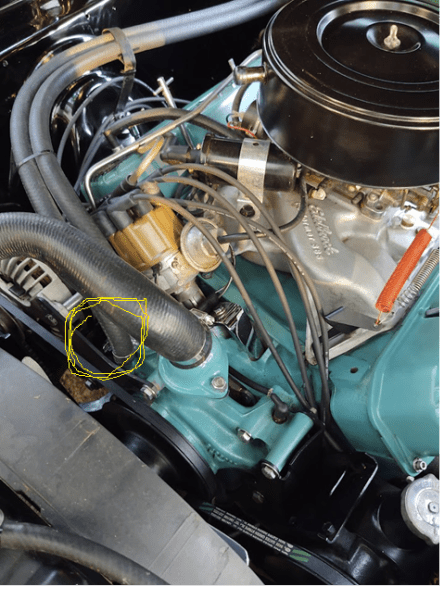

The filter is supposed to be vertical between the alternator and water pump housing.
Kind of behind the alternator bracket.
