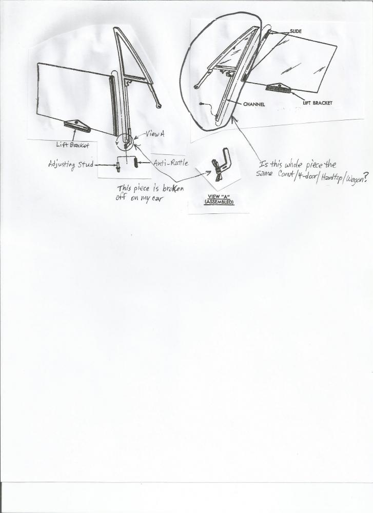

Are the vent window frames the same on a wagon/hardtop/4-door and a convertible in 1970? I'm trying to align my driver's door glass/vent.
At the bottom of the window channel (back of vent window, kinda shaped like a "V", acts as front main window channel) there is a little loop that goes over a locating pin. The pin is bolted near the bottom/inside of the door and that little loop goes over this pin along with something called an "anti-rattle" which I guess is just a little piece of rubber or something (mine is missing).
My window channel's little loop is broken off, so I cannot locate/align the channel (and window for that matter). Can I just get the vent window frame ("V") off of ANY '68-'70 Plymouth/Dodge and swap it out? If not, then what about drilling/cutting that little loop off of one of those cars and welding/pop-riveting it onto my existing convertible vent window "V"?
Thanks in advance for any help/information! Roadrunner Window Channel Diagram 001.jpg
hardtop & convert frames should be the same.
Two door post and 4 door frames should be the same
The vent frame for a 68-70B convertible will interchange with a 66-67B hardtop, but not a 68-70B hardtop. However, the anti-rattle segment from a 68-70B vent frame should work, cut & weld/rivet as you mention. The anti-rattle fits over the adjusting pin as shown. The anti-rattle insert is typically a piece of foam, medium density.

That makes a ton of sense 70Runner. Many years ago my windshield got broken and I got one out of a 67 Charger hardtop to replace it. I guess it's just a matter of the windshield angle? THANK YOU!

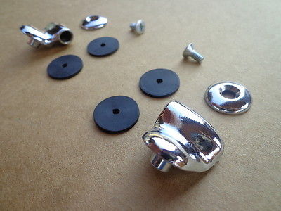

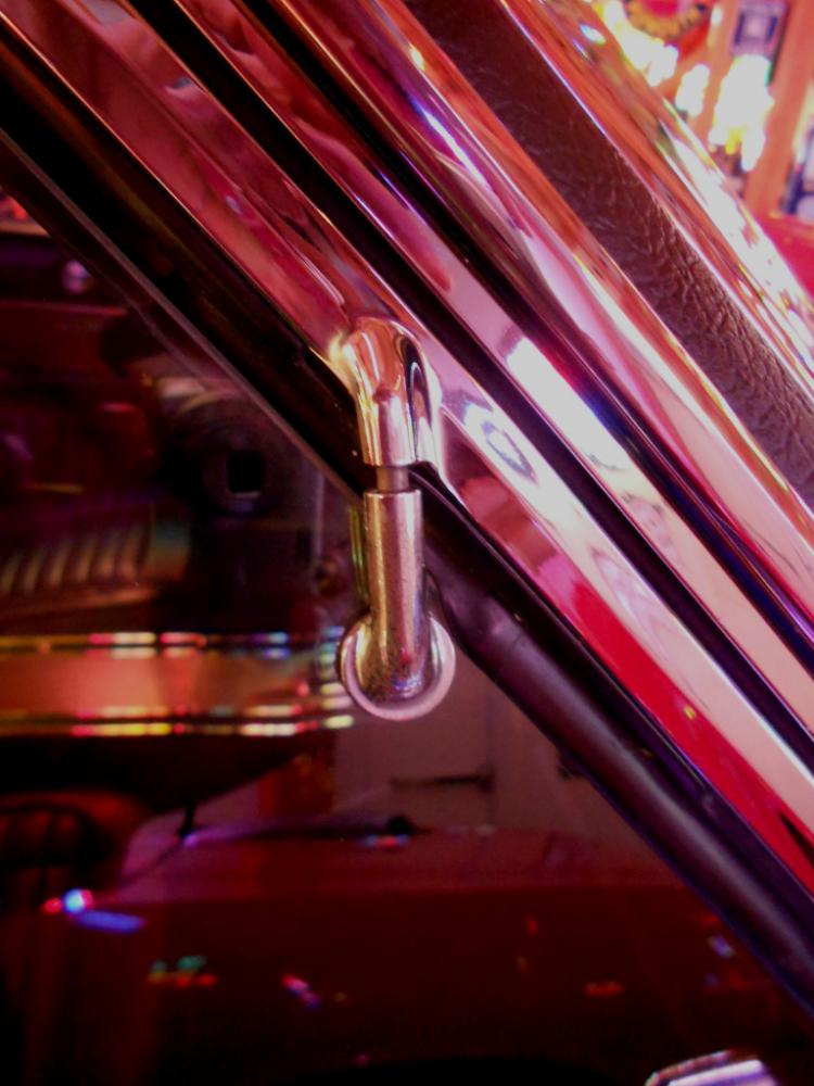

You should be fine if they are 66-67B 2 door frames. I used 67B frames on my 70 convertible, better chrome and identical to originals. Check the pivot, it should look like this one. IIRC the bottom loop should work.
not this...
