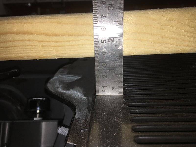

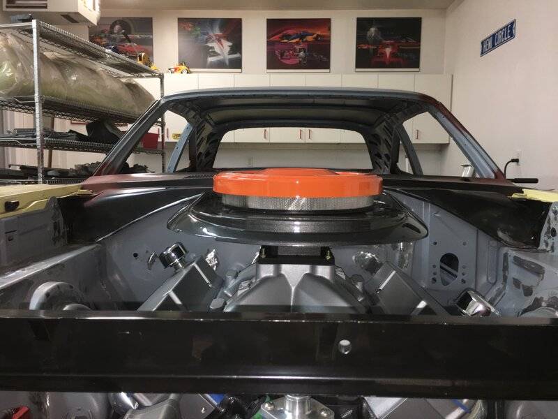

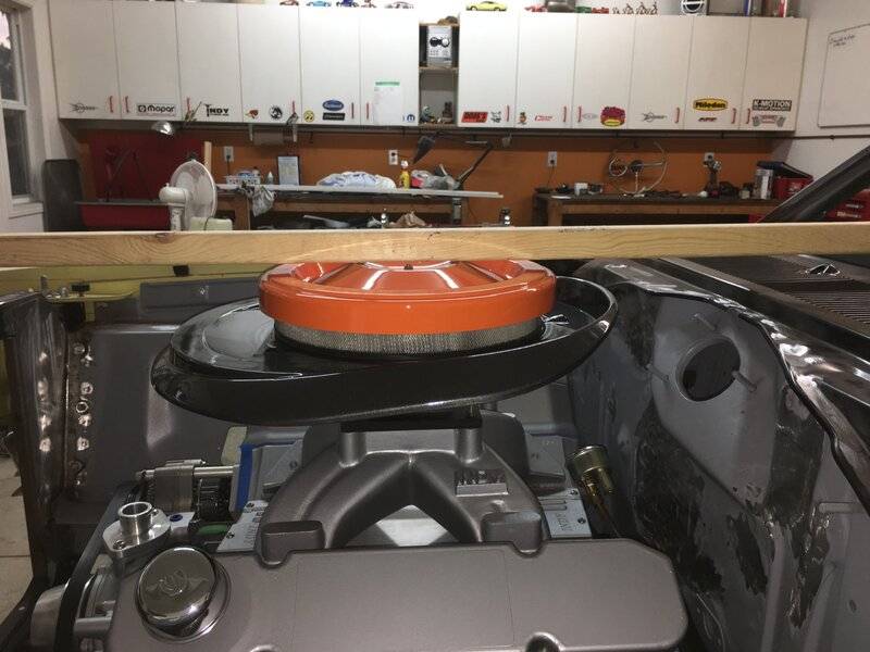

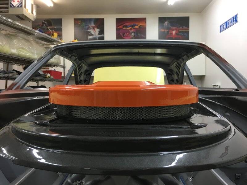

Here's a photo of a mockup - 69 RR, 440 with Indy single plane and '70 air grabber. I can't see a Charger having any more hood clearance than the RR and likewise the air cleaners are probably similar in height. As you can see, a stock hood is out of the question. Oh, that block where the carb would sit is the same dimension as a carb.

Many of the heights are published. For example, the Edelbrock Performer RPM and Demon carb barely clears the hood with a custom dropped base air cleaner under the cast aluminum lid.
The Victor is probably an inch taller.
