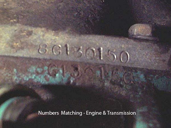

Negative. The PARTIAL VIN is on the block and the trans case both. It'll read something like 8A105486 - year, plant, sequential build number. The last eight characters of the VIN.
If your engine is a 68 look at the top rear of the motor slightly to the side of center near the oil pressure sender. The tranny would be stamped in the same area but to the opposite side of center. Do you have 383HP stamped on the front of the block? If so is there a letter before the 383?

as mentioned earlier, Mine have the last eight of the vin on the eng, and transmission bell housing.(automatic) drivers side left of oil sending unit.
yes. behind the valve cover, and throttle linkage bracket. the numbers will be on the rear lip, across from each other, where the eng/trans meet.

pic showing partial VIN on '68 block and automatic transmission. A manual transmission will have the VIN on the passenger's side pad.

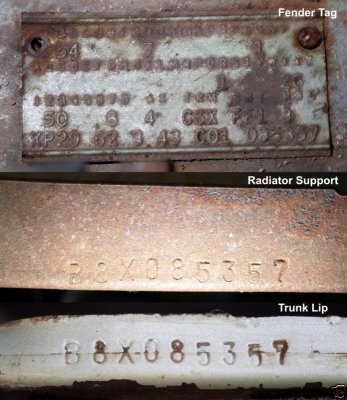

I looked at the # on the radiator support...It matched nothing on the VIN or Fender Tag.

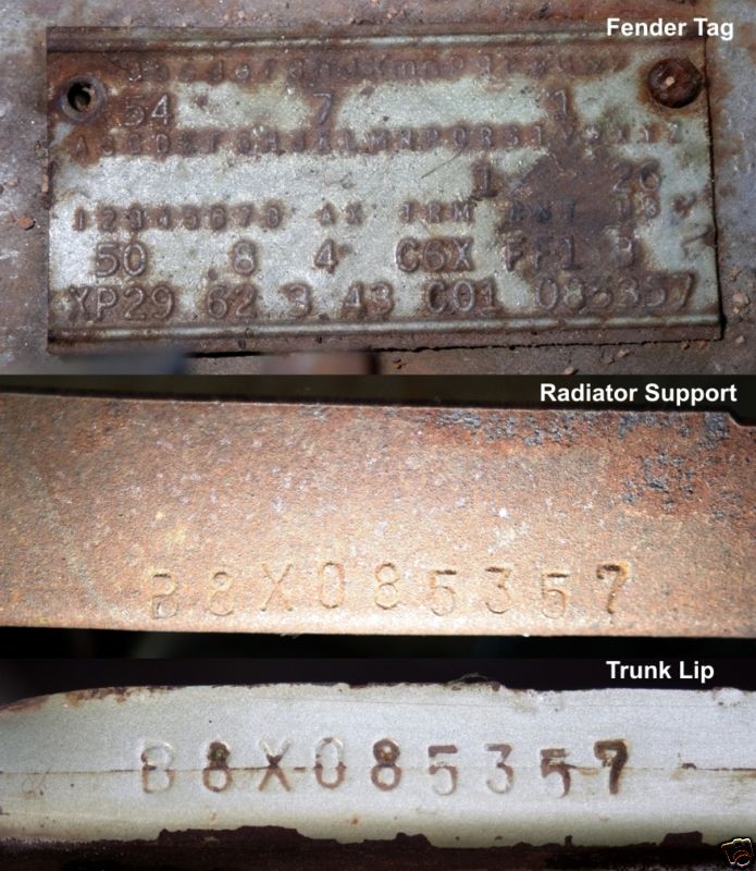

Look for something like this. First letter indicates the plant where the car was built. The 8 = 1968 model year. X= car line I.E X for Charger, W for Coronet, R for Belvedere, etc. Then last 6 numbers are the SO that should be on the fender tag. "Validate" the car? You mean you do not know what you are trying to sell?

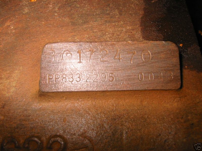

Not all 68's have a VIN stamp on the block.
Yes, they do, as it was Federal law to have them. If it doesn't, it is a warranty block or an earlier engine someone installed. You then need to see what the casting date on the block or the trans case is.
