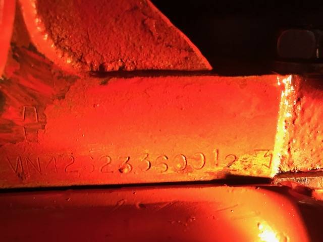

I knew the Hemi engine in my 66 Satellite was not original - I figured from the casting date of 10-31-66 it was from a 67. I thought the VIN was on the back of the block above the bellhousing but I couldn’t see anything back there - hard to see - even with a bore camera. Today I noticed a stamping on the lower left rear of the block on the rear web of the block. But guess I’m not Mopar smart enough to decipher. The full stamped number is:
VIN42623360012
That obviously is not a typical vehicle VIN but I assume it does have some purpose or meaning by Chrysler. Engine assembly stamp? Or is it more likely a rebuilders stamp?
I'm not that literate on those numbers, but try this. 426 Hemi 233rd day of 66, engine 0012.
That sounds better than anything I’ve come up with so far. The VIN prefix is a puzzler though.

I found this thread that does support the 2336 is a calendar date but from this thread my engine would fall in the 68 model year. The 68 assembled block in the thread apparently lacked a VIN stamp too. They say the prefix is the assembly plant - typically MV or MN. Sure looked like VIN to me but it’s pretty light. I’ll try to get a picture.

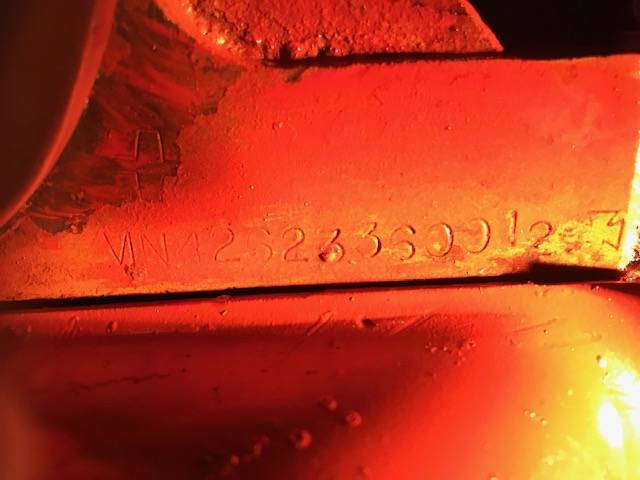

I think that prefix is MN now. The first leg of the M is missing or very faint - hard to see it clearly with bifocals and I mistook it for VIN. So that seems to clear things up and as RT Boy 67 said, it’s a 68 model year engine.

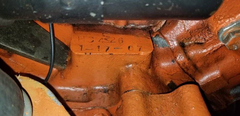

what’s the assembly date on the top pad?
Don’t really see much on the top pad. I’ll take a closer look tomorrow.
I don’t have any of that stamping on mine.

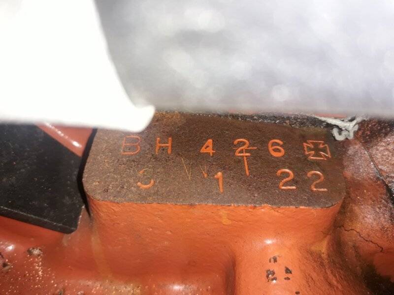

But mine does have the info on the top pad
I dont remember all of it , But
W is water tested ,
1 22 is Jan 22nd assy date
Maltese cross is 10 under rods and/or mains

Built March 1, 1966 22nd engine built

I know it was the original motor to the car it came out of which had a SBD around the 1st week of april 66 , same as my car . Which is why the previous owner bought this particular body .
The Coronet was burnt beyond repair . ( garage fire back in the 80s )
