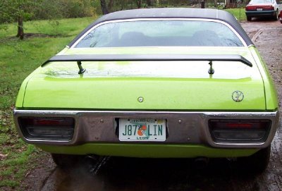

If you look at my gallery at the green '72 RR you can inspect some of my work. I did that entire car, all the mechanics, body work, paint, interior and yes the top. It is a sharp ride even if I have to pat myself on the back. What you may notice is these pictures are taken at my house is Alabama but the car was actually from Florida, Check out the tag.
I am retired now, but I am still good at what I do. It could be worth a road trip.
