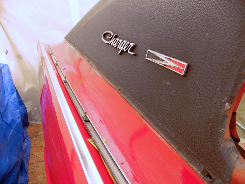

There's a little more involved here than just a few self tapping screws.
The long side piece uses spring clips

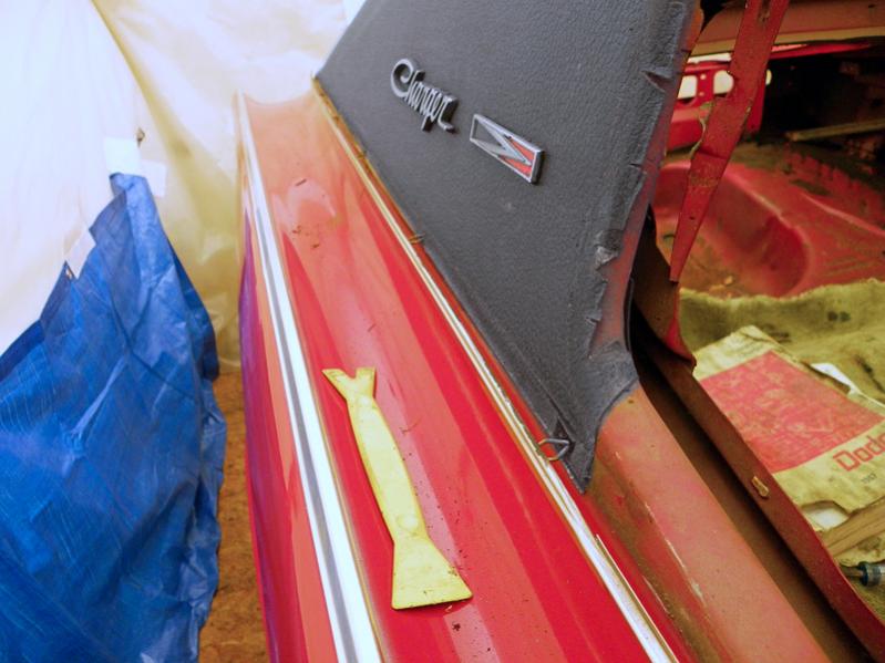

The point where the side piece meets the arrow uses another style clip. The arrow is held in place here with a screw, but...

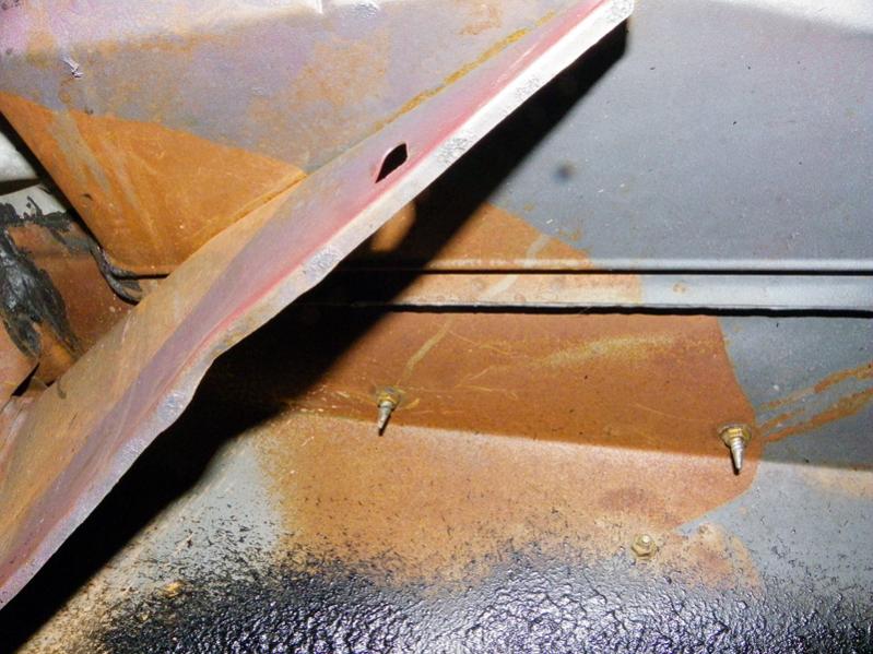

On the long side of the arrow along the trunk, it has cast pins on the trim held in place by speed nuts underneath.

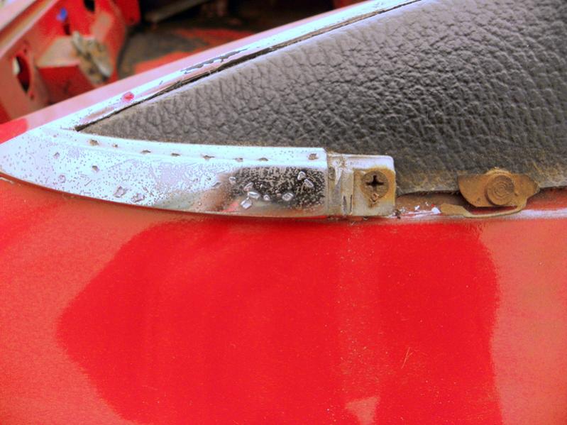

The small front pieces uses a single screw
