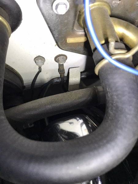

I don’t seem to have a picture of it but on 66/67 cars there’s a hole down below the ballast resister, just above the head, where a hex head screw secures it. I think later cars are basically the same for mounting the ground cable.
Yes, I did find a couple of holes in that area, I'm going to mount the cable in one. Thanks!
The black car is my non-AC car. The white car is an AC car. The left screw in the picture ( not left side of car) is the fan motor ground I think and the right screw is the ground cable to the motor.
