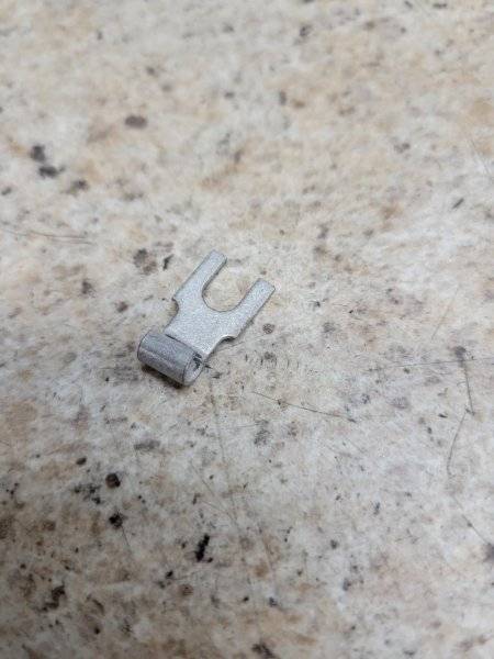

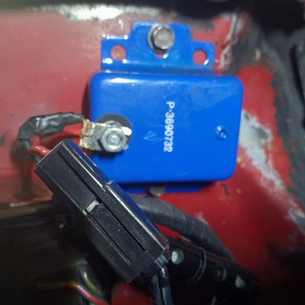

Anyone know where to get the clip and what it's called.
Thanks in advance!
Was hoping someone would have an answer to my question.
Found the name. Called a Spade or Fork Terminal.
Maybe try to reuse one off another old chrysler
Thanks, looking to stay OEM. For the life of me can't seem to find one online..

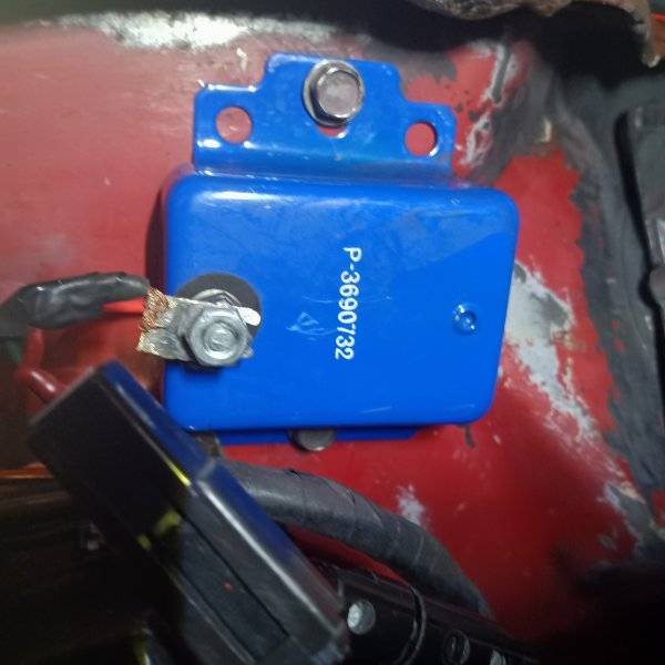

If you're looking to stay OEM, there are units that resemble the origional not the billious blue unit shown. They are redidly available but sre solid-state yet resemble origional yet provide better control and do not changing sny wiring. Due yourself a favor and ignore #4s comments about anything....

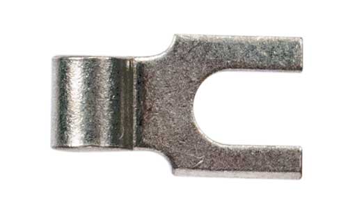

if you want OEM, the regular spade fork is not the terminal either, nor the regulator LOL.
it would be more like this:
but with this look for the wire crimp:
On a quick search I can't find the exactly right one at this moment.
Angled terminals use to be called as "flag" terminals.
The blue regulator is MP piece made for "race purpouse" being a fixed voltage rate as far I recall. Electronic reg version is intended for the same

Thanks, it's the female connector I'm looking for, just bought an OEM style VR.
"flag" terminals.
Awesome, thank you!

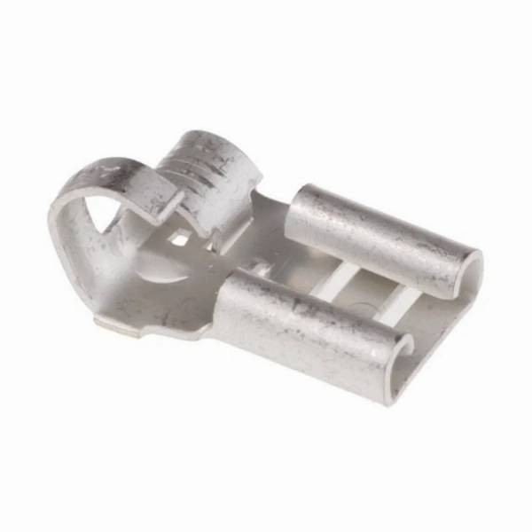

Cannot believe I can't seem to find the OEM style Flag Terminal online:mad:
neither me... I just could find the one I posted on image... similar but not the same.

just get the one I posted on the image and call it done!! several on the web... sure most of them on big bulks. the only noticeable diff will be the crimpping area shape

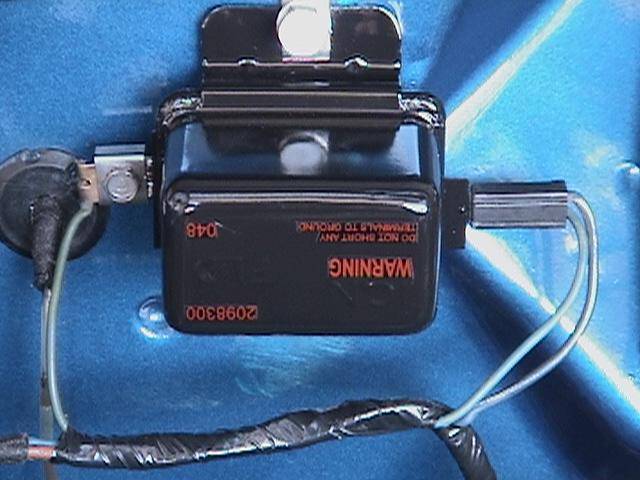

here a factory assembly still with the stock terminal:
