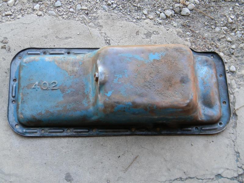

If you dont want a perfect one?????
I have this one for $45 plus shipping...
