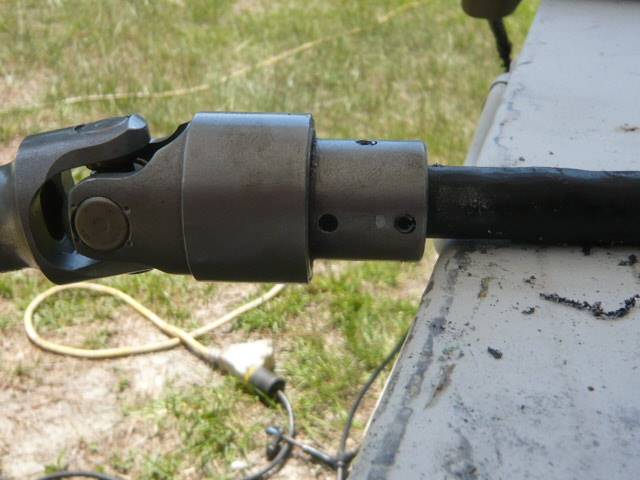

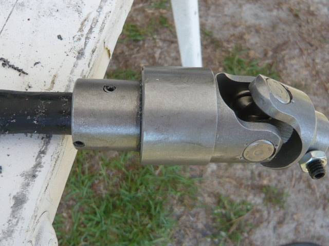

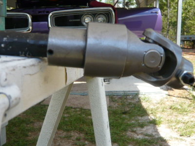

Yep Im at fault didnt check the coupler and started to install on shaft. 2 pins in and WHAT THE well I hope they will send me a new one. Also was told horn will not work so you must soider a wire over the joint on coupling. $115 for coupling. check out top hole for pin.Way to close to the edge.

I cannot see the problem. What am I missing?
5 holes instead of 6,they guide the bit threw steering shaft and the 1 hole was drilled side ways. If you look its 3/16 down on 1 side and on the edge of the other side.
somebody screwed up on the machining of those parts wonder how many out there not noticed
I cannot locate a good pic on line of both sides, but I am willing to bet that it only came with 3 holes. You drill one, pin, second, pin, and the last, then pin. I am sure that you drilled the hole cockeyed. If you drilled it by hand, you could have leaned it to one side causing it to walk. With a side pressure, the original hole will get wallerd out like using a file or reamer. It is no big deal as it will still secure the coupler and shaft in conjunction with the other two. Drill the last hole and call it a day. As far as a strap for the horn, metal on metal on metal means conductivity. Use an ohmmeter and check thru different angles and see if its conductivity is continuous.

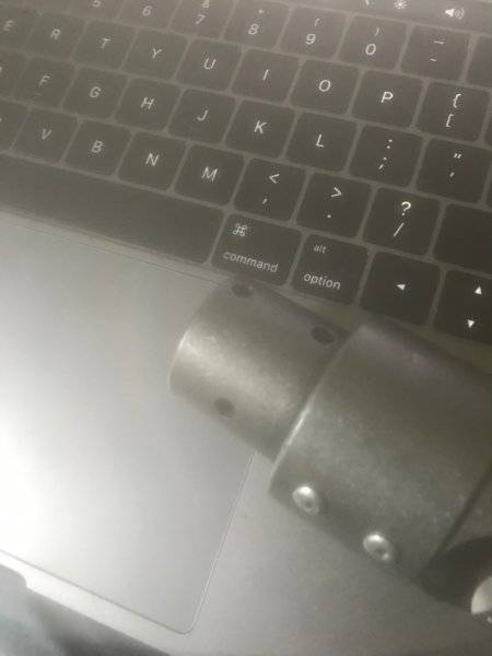

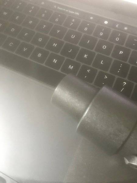

I happen to have an extra coupler sitting on a shelf (don't ask why) The holes are on one side, you just have to drill completely thru so the roll pins can be removed with a pin punch.
And I checked to make sure, the coupler ohms out, so you should not need an additional ground as long as the steering box shaft is grounded through the gears/case.
And yes, I think the upper end of the coupler could be .250" longer, however the load is torsional, very little linear stress and roll pins are rather strong. I did a double take at first. You have three pins and the wall of the coupler, so it would take a lot of force to tear from a twisting motion.
