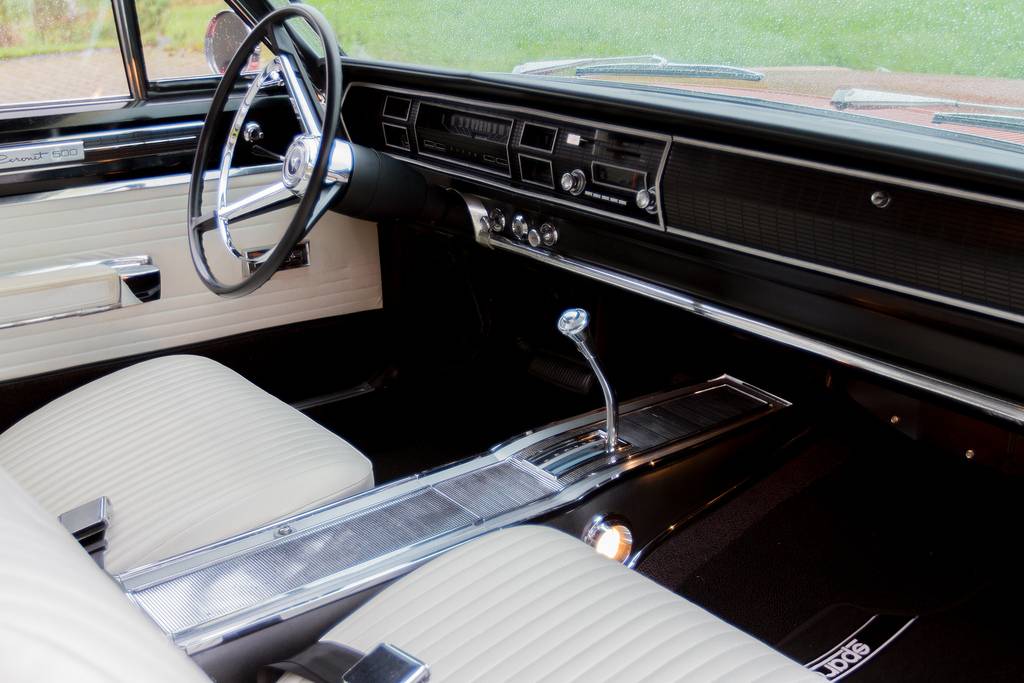

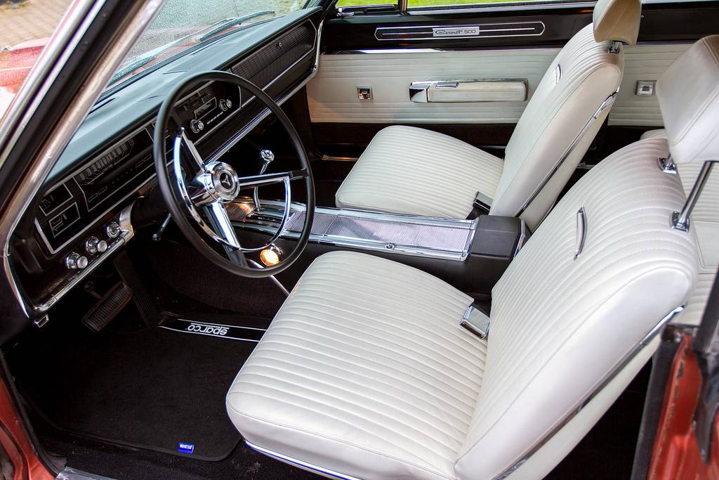

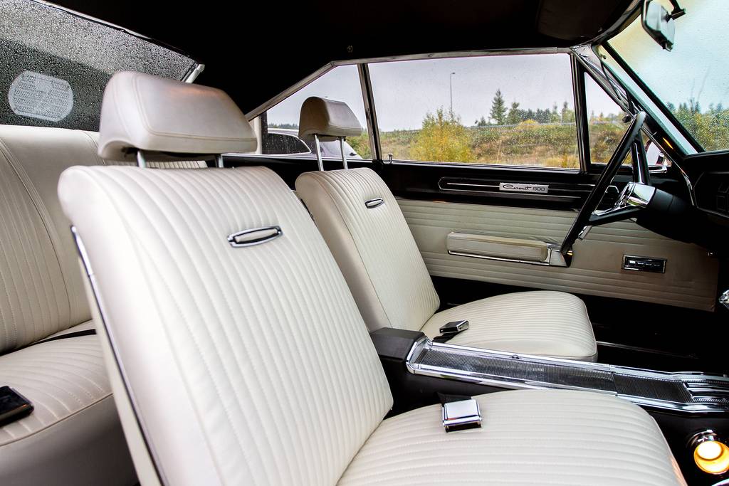

Here are some interior shots..
......man that thing is awesome!
