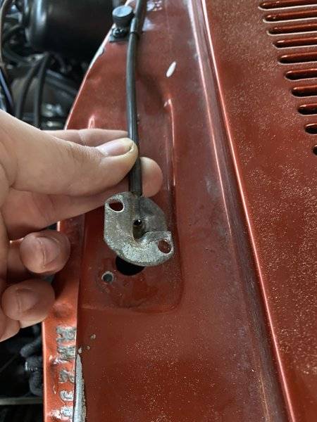

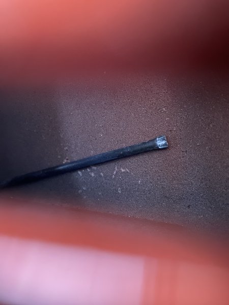

Hi guys, I installed the washer box, pump and hoses today. So far all good. After that I wanted to adjust the nozzles so the water comes to the windshield/ unfortunately the drivers side nozzle broke off by barley touching it and now it lays inside the vents…. Had some of you guys the same problem is it possible to glue or weld it? Hope I can get the broken part out through the nozzle fastening on top (Pictures down here)

Solder back together, just make it's in original position. Remove other piece from car before soldering.

If I remember they are copper or brass so it will sweat back together fine.
Just don't get any flux/acid in the tube or that solder will suck right inside.
Once you get it back together, note that the little "paddle" that sits proud of the mounting flange is to adjust the tube position, not bending the tube.
