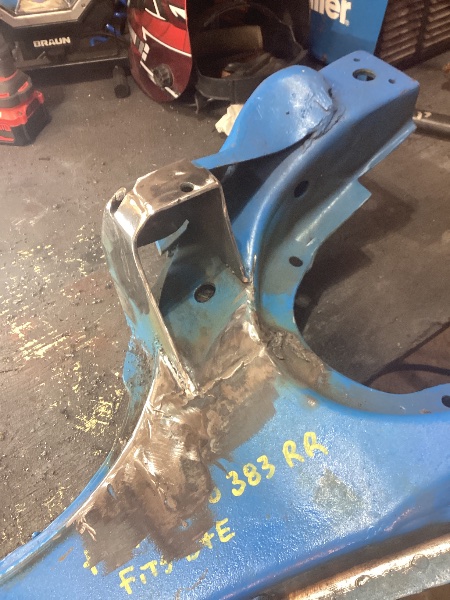

Motor mounts gone. Guess I’m committed to the motorplate now. Still a lot to do; Trim the pinchweld shelf next. Then all the welding and probably some body filler before paint. But I’m pretty encouraged by what I’m seeing so far.
Don't forget the oil pan cut out. When you can get the pan off with a straight extension and socket in less than 30 minutes you will be a happy camper.

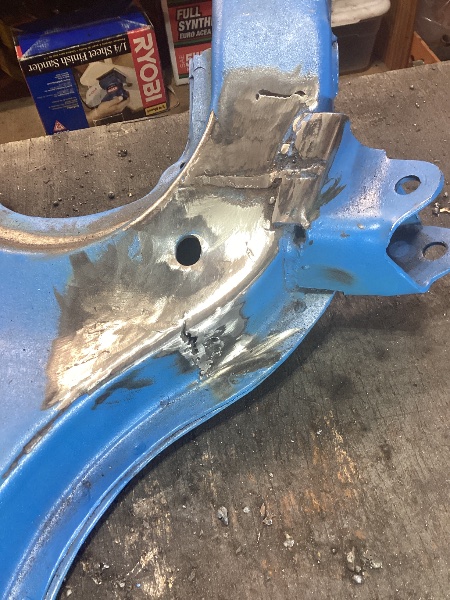

Continuing work on the K-member.
1. Rough cut with the plasma cutter
2 & 3. Cleaned up & straightened with the grinder; exposing the seam.
4 & 5. Welded up.
This thing must’ve been in a dirt-track car before I got it. I bet I’ve taken 3 lbs of dirt & grime out of it.
Probably going to call it good with the stock shape, Doug. Spent some time looking at it, and with the contoured factory cutouts @ the bottom, I’m just not sure my fabrication skills or tooling are up to re-shaping this thing. Goal was to trim a few lbs. I’ve accomplished that.
Makes oil pan removal a snap. It's lighter. It's really easy. You can do it. Start with a hole saw. Drill thru two holes for the inner corners. Then make the three cuts that connect the holes. Now you have a nice U shaped cutout. Bend two L shaped pieces. I used 1/8" material. Bend them over deep socket in the vice that creates the correct radius to fit the previously drilled corner hole. Make them slightly oversize in width and length. Making two pieces keeps you from having to make the piece the perfect length to fit the opening. The only gap that needs to be fitted now is where the two L pieces meet in the center. Trim those ends until they but in the middle of the opening. They can hang over the bottom, top, and ends. Tack weld the pieces in the hole. Trim off the excess around the edges. Finish weld. I filled the holes in the bottom openings afterwards. The fillers in the bottom holes are just sheet metal. But that was just done for looks. Done more than a few K frames for others that the bottom openings are still left open. My sons is like that. Actually did his in the car.

K-frame final product. We lost 10.4 lbs here, compared to the original K-frame. 39 lbs vs 28.6 lbs. I decided to drill some holes in the topside. Went through (2) hole saw blades without a hole developed, before I finally fired up the plasma cutter and went after it freehand. Turned out pretty good.
Of course we need to add in the weight of the motorplate, but also subtract the weight of the steel motor mounts. In the end, We’ll probably lose 5 lbs here.
Skimmed it in Bondo. Filled and shaped the dent in the driver side as best as I could. Filled some horrendous looking factory welds. And put a coat of primer on it.
Skimmed it in Bando. Filled and shaped the dent in the driver side as best as I could. Filled some horrendous looking factory welds. And put a coat of primer on it.

Even a 5 lb loss that low on the front end is an advantage. I didn't go as far as you did on the K in that just the motor mounts were shaved off. It was a nice exchange between the weight of the K motor mount brackets, rubber insulators, fastener hardware and an aluminum plate . I kept the factory pinch welded shelves simply because I didn't think about it until it was too late and it was back in the car. When I saw DVW's masterpiece up close and personal, I was like................. Damm, why didn't I think of that.
As you well know, the plate will gain you more chassis response while acting as an extra support plate just above the crank centerline, along with less weight. Win, Win.

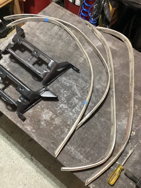

I scored a full driver quality wheelwell trim set today. There’s a couple of dings in the rears, but nothing too bad. They should polish up nicely. They were local to me, and best of all; nearly half the price of a new repop set.
So now I have all the correct Belvedere trim. Still haven’t decided if I’ll go full on with GTX badging? Put the Satellite badging back on it with GTX trim cues for a cleaner more muscular looking Satellite? Or just say “Badges?, We need no stinking Badges!” Lol.

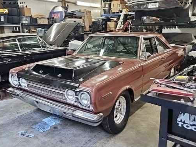

The guy I got them from has a few Mopars including a 66 Hemi Satellite; a 64 Dodge Polara Hardtop, and this 67 Belvedere race car which happens to currently be for sale. Pretty good looking car. Body is super solid. 440 with some nice parts and race-prepped 906 heads. If you know of anybody looking for a bracket or Stock / SS car, this may be worth looking at.
Nice 67 Belvedere. How much is he asking?
