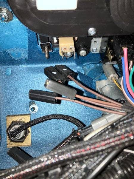

Just wondering which wires go to the washer switch on the 69 Bee. The car has a 2 Speed wiper motor
The wires with the white dots have continuity to eachother.
Thanks
The ones with the dots are just a loop, one on the washer the other on the switch
And Any One of The Other Two Brown Wires To The Other Side Of The Washer Switch?
I'm out of town but from memory yes the washer is 2 browns one from the switch one from the pump
