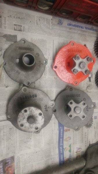

If you have access to a press you can also rebuild your own. Bearings, mechanical seal, and impellers are available. You can even buy with OS Shaft. Just ensure you use a good adhesive for installing the hub if your reusing your original. SVM even tells you how to do it.
