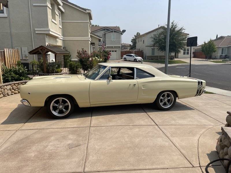

Washed and waxed the Bee today as I want to start driving it more. Last week rebuilt the brakes and all was good until I was cruising down the road and heard a noise. It is hard to describe but it is rhythmic but not metal sounding. Kind of like leaving a spark plug out but not as bad. The car revs fine, idles fine, could be a weird exhaust leak and it is basically stock 383 automatic. Hell I don’t know I am just venting right now. Popped the hood no leaks so I shut it down and walked back in the house. Sorry for the rant but at least it looks good now!!!
Good Lookin Bee.... Does it make the noise only when driving? Or when sitting still? Only when driving look at the tires/wheels/brakes..

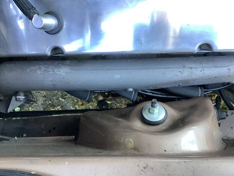

Manifolds. I bought the engine from a buddy years ago and have been running it for years now. I know he put a different cam, roller rockers(what he told me)intake and carb otherwise stock. Has only about 10,000 miles on it and has never given me any trouble until today. I start and drive it at least once a moth to keep everything fresh but only a small drive. It is about a 10 mile trip getting on the freeway and then back home.

Emotions are perfectly normal, Thank you for sharing. Beautiful Bee. Your dad had great taste. :thumbsup:
Thank for the replies and compliments. I am hoping it is just a manifold gasket but I was to nervous to let the car run and honestly after 3 hours of washing and waxing to hot and tired to do anything about it. Getting older really sucks!!!!!! I am leaning towards an exhaust gasket leak or cracked manifold. I will update in the morning.

Thank for all of the replies and help. Yesterday I was frustrated, hot, tired and was going to make a video today but to my surprise when I started the car I could tell it was a bad manifold gasket. Looking with a mirror all around the manifold I do not see a crack but will check when removed. The sound was totally different as I am guessing nothing was up to operating temperature.
I will try to get this replaced next weekend. One thing I do not remember is do the bolts for the manifold go into the water jackets? I will look this up but I know you guys here know that answer.

Yep, they sure do - and yep, it's very advisable to have a FSM (factory shop manual) for your car
(or something equivalent).
You will need to put some manner of thread sealant on the bolts before installing them back in.
yes
they do go into the water jacket
if it has the stock 906 heads & stock HP cast iron exhaust manifolds
the exhaust bolts;
they usually; 'it will have studs'
& 3/8" barrel nut &/or fine thread reg nuts & washers,
when it has 68-70 HP manifolds
unless someone replaced them with bolts along the way
good luck

Just my own experience here when our 64 Fury had intermittent popping sound from under the hood and a piece of hose listening around the exhaust manifold. I had the manifolds resurfaced and that’s all it was. Hope this helps you.
