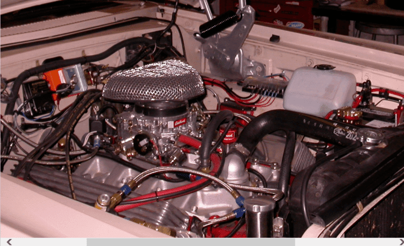

Nitrous, and when you blow all hell RB time.:thumbsup: This was in a friends 65 Dodge Coronet 4dr ran low 13 teens 100 mph plus with 100 shot of Nos.

View attachment 650435 Nitrous, and when you blow all hell RB time.:thumbsup: This was in a friends 65 Dodge Coronet 4dr ran low 13 teens 100 mph plus with 100 shot of Nos.
Looks great but when that style of air cleaner lights off after a back fire, you will have a hard time putting out any fire it creates unless you have a fire extinguisher on hand. Foam is nasty once it's on fire. Axe me how I know!!
He sold the car $5k and went to the dark side. Making a 2 lane black top special.
