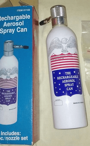

I have recharged more than one can with shop air as Kryslerkid suggested in post 11

I worked at a fab shop that would buy it in bulk. We had metal quart spray cans that we pressurized with a air hose. Sprayed the baskets of welded parts down so they wouldn't rust in storage. If you poured some in a clear container you could see stuff floating in it. (Animal fat?)
