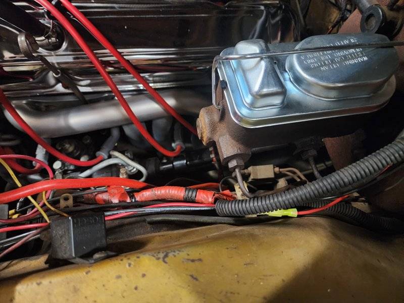

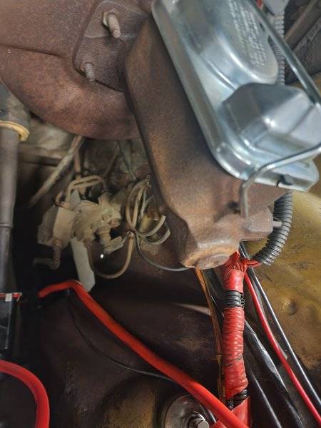

So 70 Plymouth Road Runner disc brake car and master weeping under gasket so looking for ideas to what might cause it or seal it. Tried my spare gasket and still some weep. Think cover bad. Ideas or open to buying a new cover if members have a clean one. Thanks guys

You may possibly have a master cylinder that is rust pitted on the mating surfaces allowing for the weepage? Worth a look..

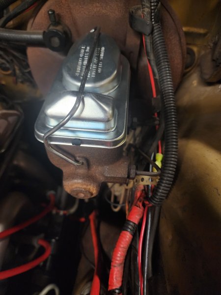

I had the same problem with the master cylinder on my 71. Couldn't find anywhere to buy just the cap and gasket. Went to napa and bought a new master cylinder for about $50. Didn't really want to change the whole master , so I took the new top, gasket, and locking wire and installed it on my old master. Fixed the problem and alot less work then changing the master and bleeding the system. And now I have a spare master cylinder if my old one ever goes bad

Mine tight but inside looks pitted around edge

I would say try it if it doesn't stop the leak then change the master. Mine was always wet but now bone dry.

I use to have fluid leaking. I put the locking wire in a vice and gave it a little more angle. Leaks no more and a bit harder to lock in place. I figured that that wire must get a bit fatigued after many decades.

Take a look at how the wire clamp holds the cap on and determine which way you'd need to gently bend it so it applies more down force. (I made the 'V' part of the wire clamp a bit more narrow.) Then remove the wire clamp and lid. Clean the top surfaces of the MC and gasket of any debris. Put the wire clamp in the vise so that you can bend it. It doesn't take much. When you reinstall the gasket and lid, you'll notice its pretty hard to snap the wire clamp over the lid. If its too tight then you bent too much.
