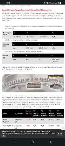

The weight is opposite the tiny hole in the flex plate close to the crank bolts. Kim
And if I recall, the 440 gets 2 weights, one on each side of the drain plug.
I have a 73 motorhome 440. So when I'm looking through the inspection cover how will I know which flat to put the weights on? There are 4 options.
That's great! Thank you! So just 1 weld bead across the bottom is ok like in that picture? I don't want a weight flying off through the floor of the car and hitting me in the corroded artery!
Me, I would do the flex plate with the bite out of it. Would not have to wonder about weld quality then. Plus gives you the advantage of using other non weighted converters which can be a little easier to find.
