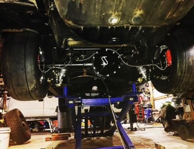

Street lynx installed in my 67 coronet, you can order it with spring relocation boxes.
Pretty much identical to the street lynx
Not at all. The street lynx is a triangulated rear link setup, the one I got from Gerst is a parallel 4 link with a watts bar setup. Entirely different set ups
They offer both, the one I clicked on was a triangulated 4 link
