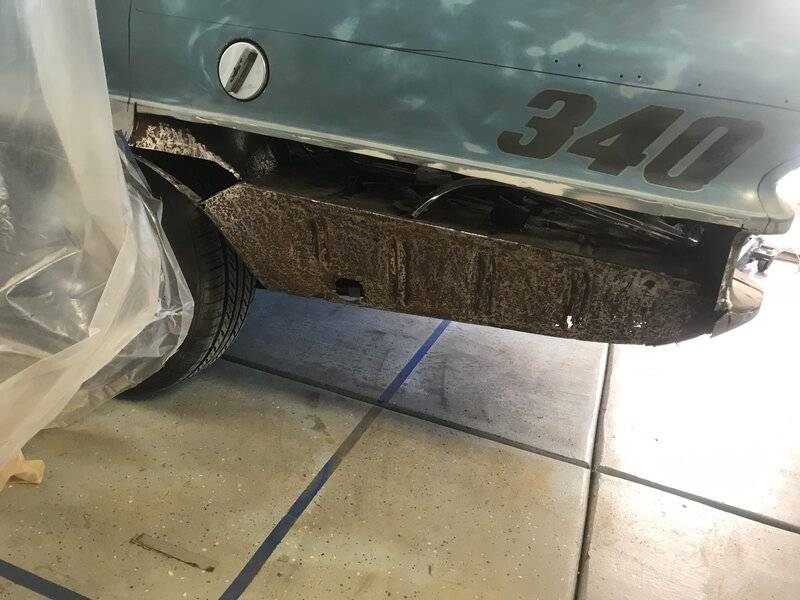

I need to patch my lower rear quarters below the style line. Mechanically inclined but never welded before. Will this simple welder do what I need to spot weld a few patches? Not getting into the welding business. Either this or panel adhesive.

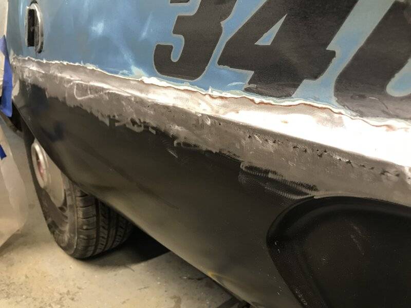

It will work but if you can put a piece of copper behind the weld to soak up some heat. And move around dont try and weld 3 inches at at time. Move around and just do spot welds. Even the cheap Harbor freight welders will burn through the thin sheet metal. Just go slow and take your time. I used the same style welder on my 67 Belvedere and it worked ok. But if you are like me you probably need to be a great grinder to fix your crappy looking welds.
If you've never welded before make sure you practice a bunch before trying out a patch panel. Keep a damp/wet cloth at hand to cool your spot welds as you go. This will minimize/eliminate panel warpage.
As mentioned above, spot welds only! do not run a continuous bead as this will certainly warp the panel.

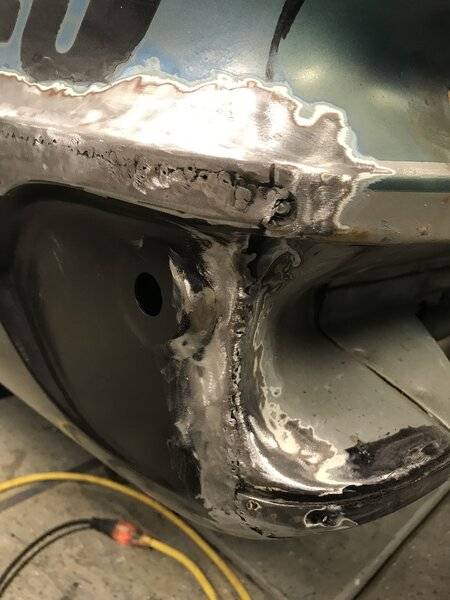

I’m doing the same. Went with the Eastwood DC TIG. Also needed to butt weld a plug into my air cleaner where the snorkel went had to be perfect for the chrome. I feel I have better control with TIG. Can also go back and re-flow the weld without adding more material.

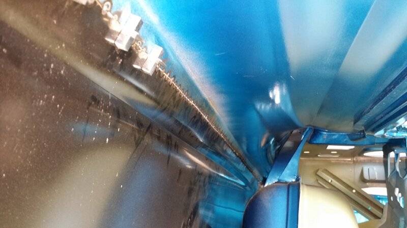

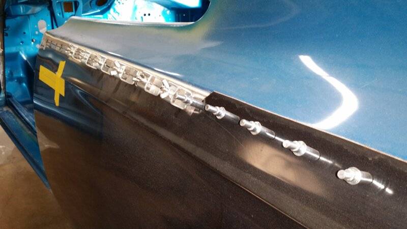

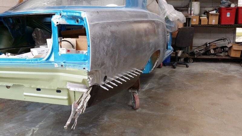

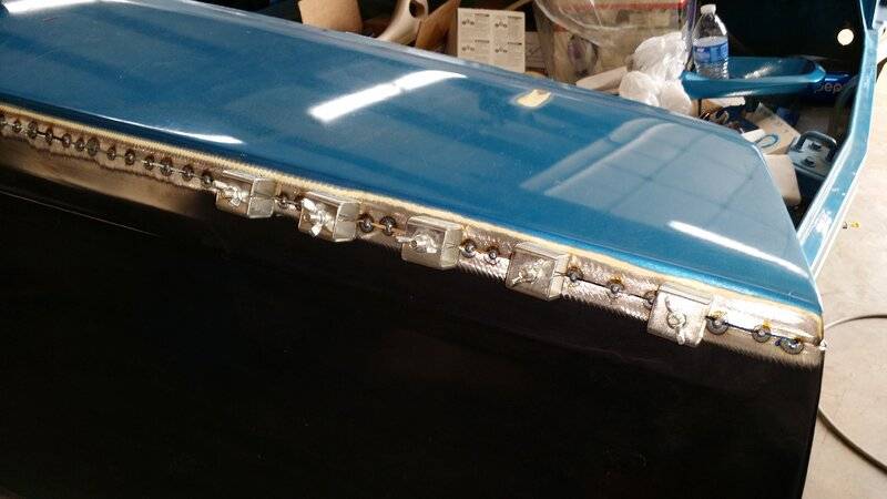

When "Tacking" your repair panel on, you want to move around to keep the heat down! Tig puts
too much heat in the part. MIG is Cool. Do it just like this with Cleco's and these panel clamps from
Harbor Freight. Oh, and use 0.020 wire! They work great!

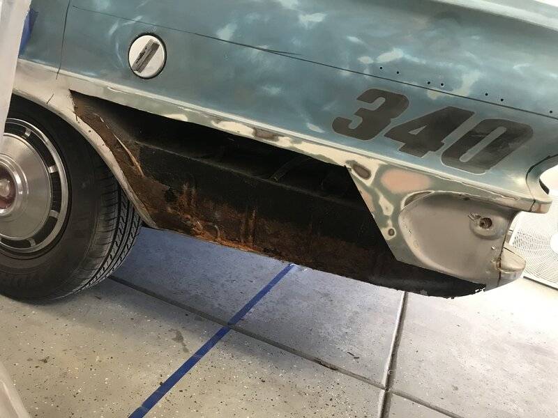

On my 64' Polara i had to do around the rear wheel arches. Butt welded with mig ( wouldn't use flux core) and did use 3m panel bond on joint of wheel house and quarter panel repair panel. Even with weld through primer i feel like welding creates rust between the panels , bonding won't.
