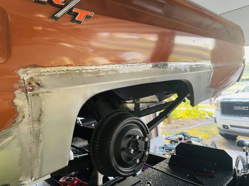

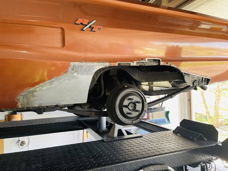

Time to weld pin holes and low areas, grind, then some evercoat Everglass short strand, then rage ultra, then some dolphin glaze and onto primer!

Still got some pin holes to fill with the Rage and Dolphin Glaze. Sand, sand, and sand again but getting better each time.
