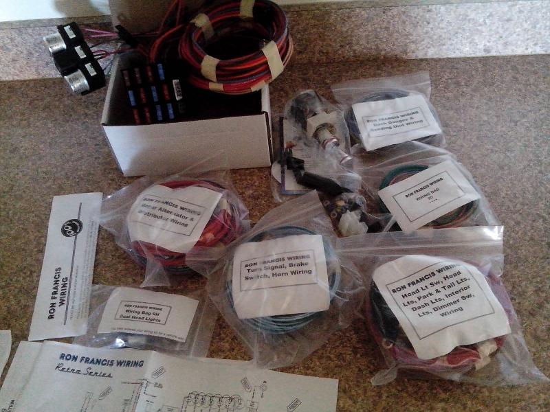

Ron Francis came by just now... 1407878068408.jpg1407878445539.jpg1407878631227.jpg1407878540139.jpgc
DId not expect a head light switch... bonus... this will save me some time and money on my harness.... this is the retro kit....

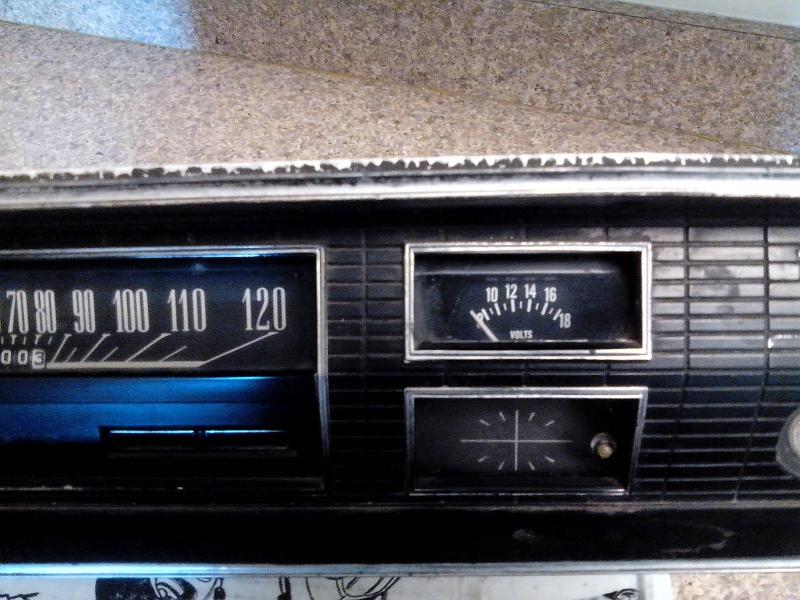

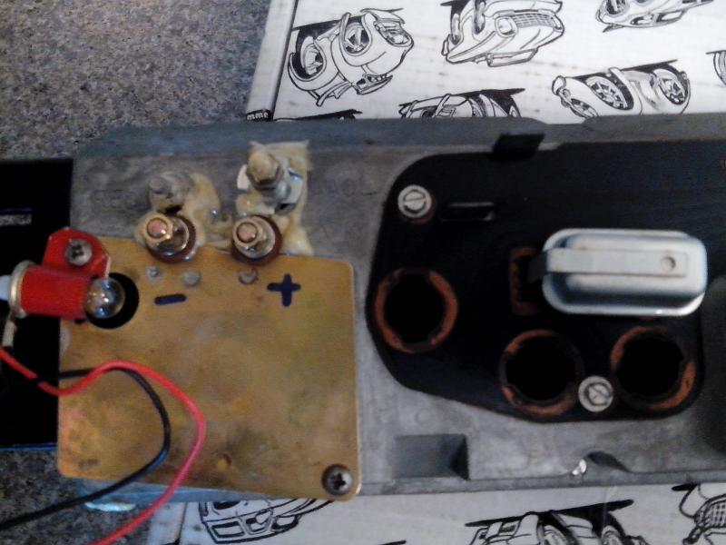

Now the fun begins... along with the relays and wires I have for my sterio and the rebuilt dash....1407879254875.jpg1407879311351.jpg
The dash was redone at bobs speedometer... I did the volt gauge conversion with a 2 1/8" retro style autometer gauge.. and married it to the old gauge... this was a cluster I bought junk from ebay and( my original is still in the car.).. it also was chopped up fir an 8 track which was.why I got a deal on it also.. which is perfect for my player I had redone at Gary's 8 Trac in Arizona....
The bottom component is a line converter.. it smoothes out the signal from the head unit like an eq and static suppressor... so the amps get it clean And it makes the old technology sound better... one the deck is redone

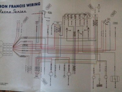

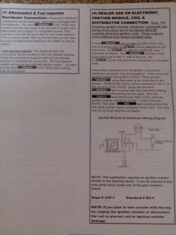

Im in no rush to get it done in this heat down here... but if it helps this is the papers that came...
1407893800523.jpg1407893973440.jpg1407894044241.jpg1407894097273.jpg1407894151621.jpg1407894197743.jpg1407894243571.jpg1407894340796.jpg1407894404307.jpg
