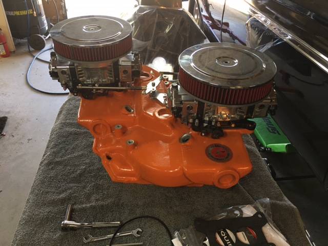

Looks like you ran aircleaners? What's the (2!) aircleaners weigh!

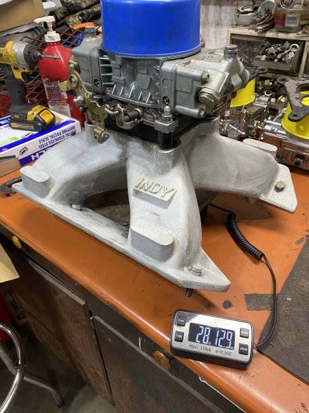

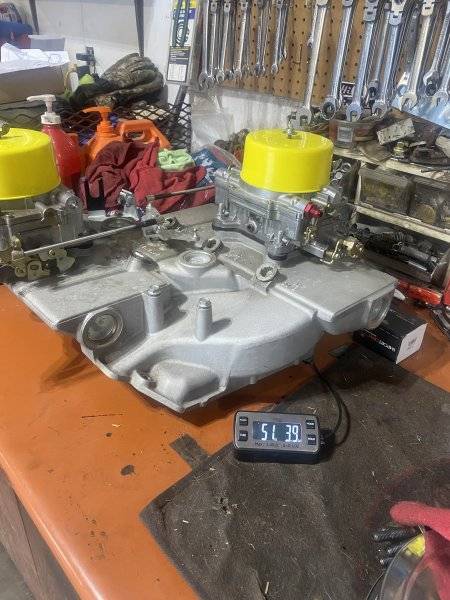

That's why the Single plane and Dominator are reputed to be quicker. They weigh less. Oh, twin Holleys are about 6 lbs heavier than the pair of Eddy's

I bet you’re pretty much dead on with that.
So it should run exactly the same with 2 carbs, all sorted out. Ish. We'll see hopefully.

I was going 10.45 with 2. Switched to 1 and it went 10.37. Weight had a factor in the difference.
Last year when I put the single four on, I picked up two tenths. Hopefully I can get it to run 1080s with the cross ram.
Well if that Indy is MW port - I may be able to take it off your hands if you decide to stick with the cross ram. Plus there would be no shipping :)

Mine with AFB's, best ever 9.00@149. With a very nice set of cutom built Holley's, 8.96@150. I will say the Holleys are quicker in poor air than the AFB's by maybe a .10
