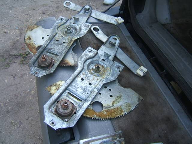

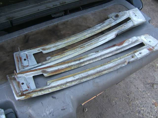

here are pics of some spare regulators and guides i have from a 71 sat

Is the glass the same for fixed or roll down? How hard is it to switch from fixed to roll down?
71's the regulator glass is glued into a channel and the 71/4 fixed glass will work in 71 regulators. 72/4 glass bolts to the reg and the fixed glass will not work in the 72-4 regulators.
