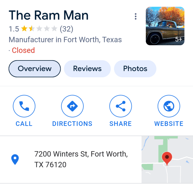

By George, he is in Fort Worth.
Ram Man started offering disc brake conversions for older trucks(for the rear) and he bit off a lot more then he could chew, and from what I could tell didn't handle the pressure very well, or the type of comments a youtube video open to the public will generate.......
