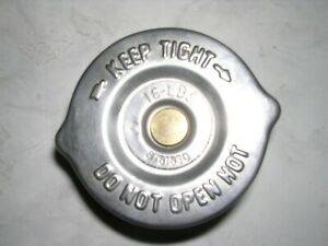

I currently have this

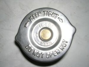

That is just fine as long as it has been tested to hold 16psi. Then make sure radiator is not filled all the way. Then drive n see what happens.
